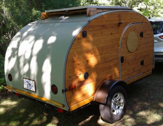

Postby TimC » Thu Mar 02, 2023 9:59 am
After refinish in 2020
Finish your exterior walls flat on the bench. Let the finish soak in. First application was several coats of 50:50 Spar varnish:mineral spirits. Then several coats at 75:25. Then two coats 100%. Sealed any exposed end grain including end grain not exposed to highway wind/rain with skin coat of 100% silicone. Then waxed entire side walls.
Inspect, inspect, inspect. Monthly, yearly for any problem areas. There will be some. Regular inspections will eliminate blemishes from becoming problems.
Refinished once (2020) since original build in 2016. Spar varnish cut 50:50 with mineral spirits. Then 75:25, then 100%. It wasn't necessarily needed but I was doing a paint color change on roof and did a complete job.
Stored under cover most of the year.
There's a reason they stopped making woodie automobiles. The average auto owner is terrible with routine maintenance. But if you love wood and don't mind the maintenance go for it.
Tim

Postby TimC » Thu Mar 02, 2023 4:14 pm
Wendellnla wrote:...
Concerning refinish, what prep work did you need to do? I was leaning towards a non varnish finish to avoid the need to sand or scrap old finish off.
Hand sanded with a sanding block and used a small scraper to scrape out bits that were flaking away (not much). I really just needed to scratch the surface to get the new finish to adhere. Again, regular maintenance made refinishing easy. Neglected maintenance makes for a big task. Cleaned with mild detergent. Refinished. Not as easy on vertical walls compared to original build with walls laying down but doable.
During build, how did you attach cedar to exterior? Over time plywood sheathing or direct to studs?
Walls were 1X laying flat. Rigid foam insulation. 1/4" ply on outside and planks were glued (TBII) and brad nailed to the ply. Then finished laying flat on trailer bed.
Nice looking trailer btw!
Thanks, I like it. There are arguably better ways to do this (just listen to the epoxy fans). I just prefer not working with epoxy. A personal preference. I recognize that fiberglass may result in a more waterproof build but I have had no problems and I like the ease of PMF.
Tim

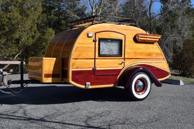

Postby Juneaudave » Thu Mar 02, 2023 6:38 pm
Cedar strip in the style of a cedar strip canoe can work....this one was finished in 2008 and the pic was two years ago. 6 oz glass, epoxy and auto clear coat has worked well on this build.
