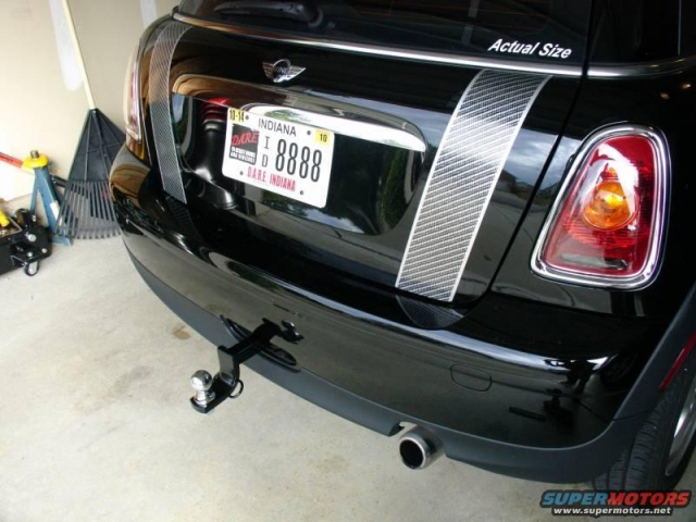

Update: Friday night I finally installed the hitch on the mini. Took my laptop out to the garage and watched the installation youtube video from e-trailer step by step, pausing while I worked so I didn't miss anything. I took both rear tires off in order to access the screws easier. Had to loosen the spare tire a little until I got the hitch installed, then I tightened it back up. Forgot to take any pictures of the process, but I can say that installation was very easy with the video. The Mini Do More hitch that I bought came with no instructions. Ran to Walmart to grab a 1.25 inch draw bar for $20 which was not long enough. :x Gonna have to return that one. Ordered a longer draw bar from e-trailer for only a couple of bucks more plus shipping. I was not going to spand $80+ for the same draw bar from Mini Do More. the only thing is that I will have to weld 2 chain links on it for the safety chains when it comes in. This weekend, I will wire up the trailer light kit and then do several test runs with the teardrop. I figured on most of our small weekend trips we won't be taking the grill, cookware, or food items since most of the time we like to hit the mom and pop restaurants in the area we go. Basically we will be packing our clothes, the climate right AC, bedding, and a few other items we will need just to stay for a couple of nights. Look forward to being able to leave on a whim without worrying about paying $$ for hotels. :D maiden voyage with the teadrop + mini will be June 19 - 21, our anniversary. :D Hope everything goes well!

So this weekend my drawbar came in. I welded the 2 chain links to it and repainted it. While it was drying I went ahead and installed the trailer brake light module in the boot of the mini. Instructions were right on point and took about 35 minutes to do. When I hooked the teardrop up, lights worked perfectly and everything worked great. Pulled it around town and a few farm to market roads for about 20 miles testing it out. This is what I found:
-The weight of the teardrop did not make the rear of the mini sag at all. I didn't think it would anyways since I can pick up the tongue and move it around with one hand. All storage is either on top or behind the trailer axle.
-I get a 5 second light bulb warning when I start the mini with the hitch in place because it senses that I removed the middle tail light.
-I can pull it 60-70 mph no problem on flat road.
-On hills, I tried sport mode and also tried manual shifting and had no problems with either. Not once did the RPMs go any higher than normal driving.
-On flat road, I couldn't tell the teardrop was back there.
-Stopping was not a problem.
June 19 will be our first trip with the teardrop and mini cooper together. We will be staying 2 nights at Black Rock Park on Lake Buchanan. I was lucky to get that spot, all other state parks in the hill country are booked full this time of year! Yesterday, I went ahead and ordered the Climate Right 2500 BTU AC. Expensive? Yes! Was my fiance happy with my purchase? No! :frightened: Was it worth it? We shall see! I felt that it was my best bet over just redirecting air from a Window AC into the teardrop because this one is climate controlled and the window units would surely freeze us out of it since our teardrop is smaller than the average teardrop. This weekend, I will install the climate right and post the results.

Postby bc555af » Mon Jun 15, 2015 8:07 am
I installed the Climate Right which works perfectly in this little teardrop. I could turn it into a refrigerator if I had to! Also, I welded a little bead on the thread of the hitch ball as a last resort safety precaution in case the bolt comes loose. Torqued it down and adjusted the harbor freight hitch on the trailer. I store the climate right and spare tire at the foot area behind the axle, making the tongue weight even lighter. Pulled it around again this weekend on a little joy ride on the farm roads and pulls nicely. I need to get the official weight on it though. My guess is around 600 lbs loaded after switching out some gear. Leaving Friday morning to Lake Buchanan and won't be back until Sunday. :D
