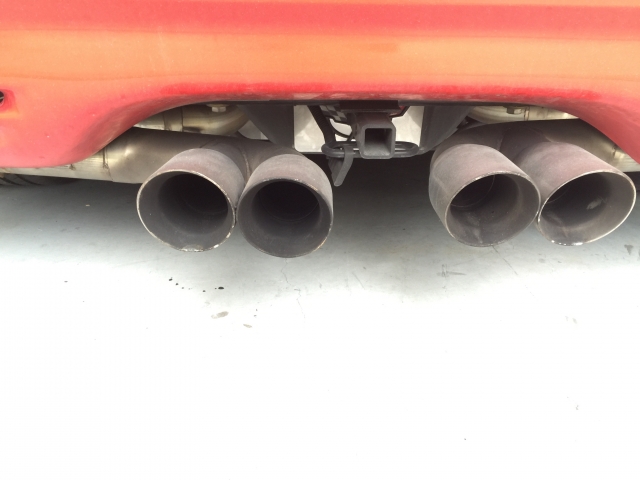

Postby flbikejunkie » Thu Aug 04, 2016 10:20 pm
I have a C5 Corvette with a class 2 hitch. I installed primarily to mount a hitch mounted bicycle rack on my convertible. I have not towed the teardrop since I have a pickup truck for that purpose but feel it would have no trouble. I have towed my utility trailer on runs to the HD. Here is a picture
flbikejunkie
