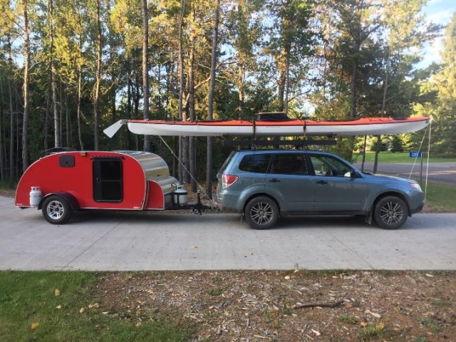

Postby Dusty Mark » Mon May 14, 2018 1:57 pm
I've towed for two seasons with my Forester. My trailer weighs about 1,500 pounds fully loaded and has about 200 pound tongue weight. I had a bit of sag in the rear, so I installed some racing springs. That fixed the sag and the ride is only a little bit stiffer now. We switched over to an axle with trailer brakes this spring. I don't treat my Forester very well and it seems to handle it in stride!
