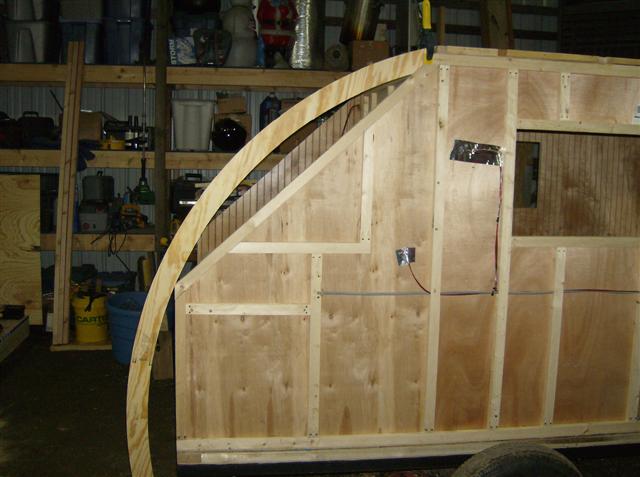

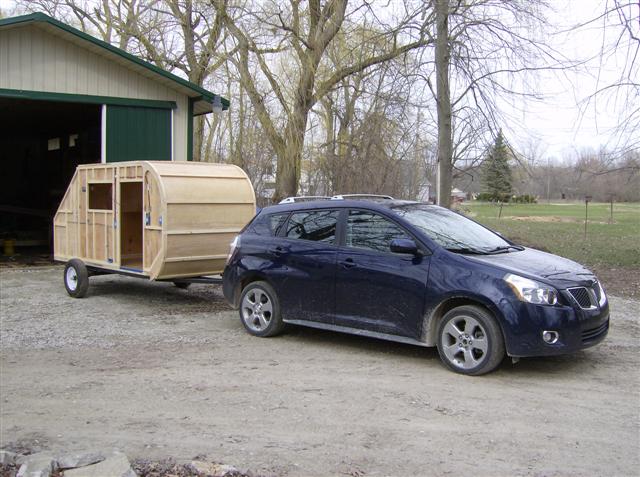

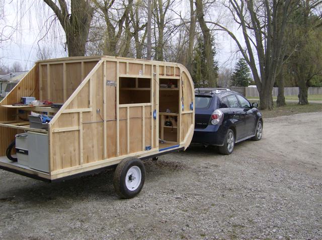

Postby Anthony J Grant » Fri Apr 10, 2009 5:16 pm
Aunti,
I have been thinking too much, I need to get building again before I convince myself to build a second floor. :hammer:
Cliff,
1340lbs? I'm going to have to take another look at your build, maybe their is hope for me yet. :thumbsup:
Thomas,
I'm with you, what will be will be, I just hope I wont have to buy a new TV, new or used now is not the time! :thinking:
Just a few new pics to keep the bubble in check! ;)

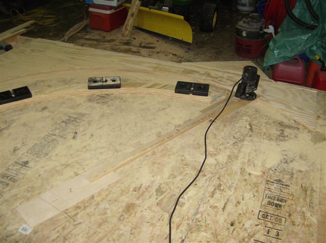

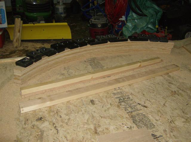

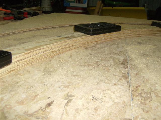

Postby Anthony J Grant » Sun Apr 12, 2009 8:31 pm
Hey All,
Started the hatch, 4 ribs cut, 4 to go. Im going with 8 total, 1/2 ply, 3" tall on a 55 3/4" radious.
Started by mounting a pencil on a stick and drawing out the ribb, I then started to cut them out with a hand held jig saw. :thumbdown: Quickly realized that was going to take a long time with less than steller results.
I opted to mount my router to a stick and drill a couple holes at the oposit end at the desired length to creat the inner and outer radious.
I was able to get 5 ribs out of a 4x8 sheet.
The weights will keep them flat until assembly.
I need to add a little frame work to the wall to meet up with the inner radious "less the space for the gasket". :thinking:

Postby 2bits » Sun Apr 12, 2009 10:12 pm
God work! I got 5 out of a 4x8 too, I used a jig saw and did ok, but the belt sander was a big help :lol: I am glad you are doing a rounded back too I was wondering about how that was going to be designed. :thumbsup:
