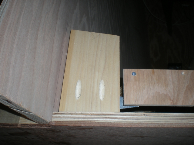

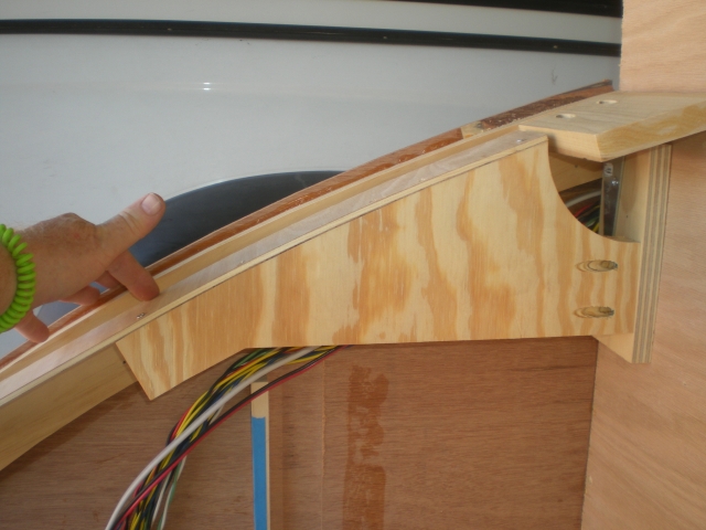

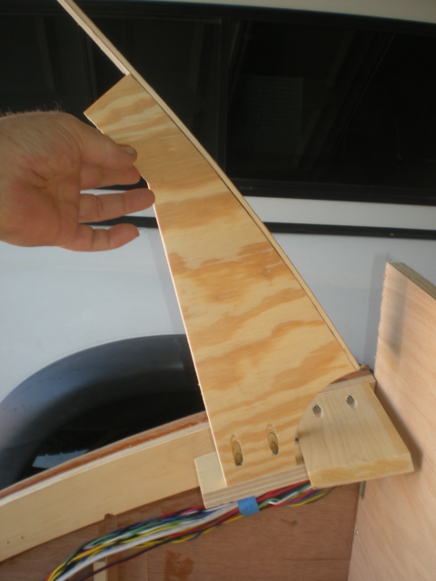

KCStudly wrote:Any reason for making the notch between the 'C' part and the rib part so deep, and the 'C' section there so thin? Why not leave this "meat" in for added strength?

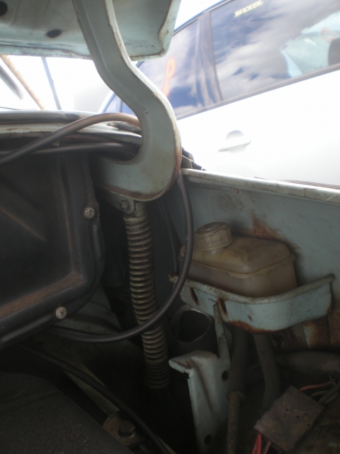

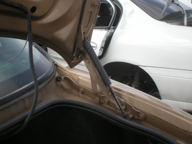

mezmo wrote:,,,have you thought about using:
Car trunk lid hinges?
mezmo wrote:Just throwing it out there for consideration.
capnTelescope wrote:I've been contemplating a trip to a pick-your-part to do some research and/or part finding.
mezmo wrote:something like the above may be cheaper and stronger.

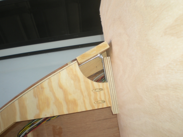

KCStudly wrote:What will keep the rain water from rolling down the roof and hatch into the top of the galley?
about hinge 3.0?KCStudly wrote:Why not leave this "meat" in for added strength?
It is a gate hinge. It's a gate hinge because that's the hinge I had. I'll get good heavy door hinges if this design goes to build.KCStudly wrote:... what looks like a gate hinge
Yeah. I'm not happy with that part, yet. Actually, it would be the top end piece of the hatch frame. I mentioned earlier about layout. This piece as-is doesn't positively locate the hatch ribs, which is very 'portant for good fit. Needs more drawing board work. There will be a hatch hinge 4.1.KCStudly wrote:...and perpendicular plywood mounting plate.
KCStudly wrote:Are you planning on using a harder wood for the hinge spar in the beta test?
