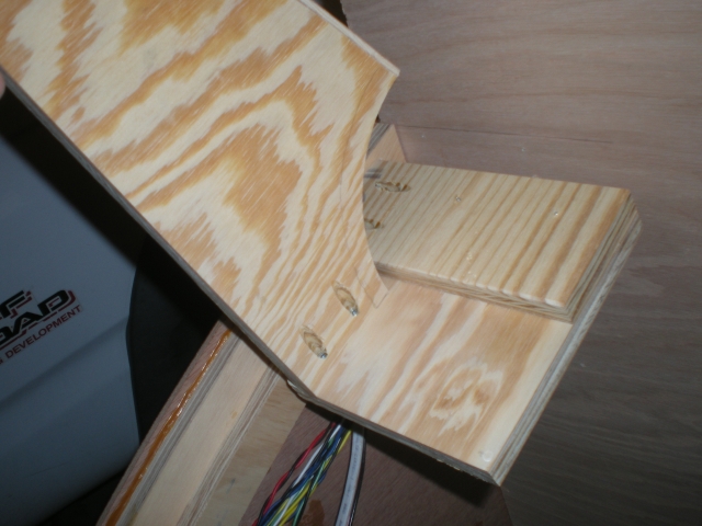

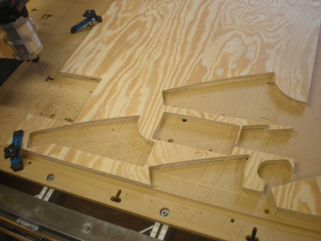

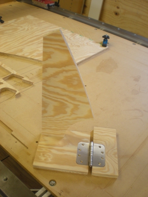

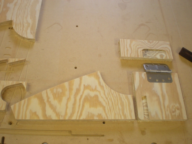

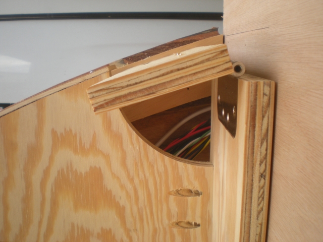

OK! I think I have this thing figured out. Went to HD and got me some shiny new door hinges. They look like stainless, but don't say that anywhere, so maybe brushed nickel. But nice and heavy and solid. With something to take measurements from, I headed back to the drawing board, and came up with Hatch Hinge 4.1. Hatch 4.1 is a refinement of 4.0, which was a "proof of concept." I will build the 4.1 version. :P
The 4.1 design consists of four parts: Clockwise from the top, the galley spar, hinge, hatch frame end panel and hatch spar, shown here.
One of the major problems with 4.0 was that I couldn't accurately locate the parts in the space-time continuum. :roll: I've got that problem licked now, as this picture tries to show:
The galley spar will fit into pockets on the Tear walls, the hinge fits into pockets in the galley spar and the hatch frame end panel, and the hatch spar fits into a pocket in the hatch frame end panel. All those pockets to be CNC machined. The head bone's connected to the neck bone... :M
All these pieces and all these versions make for an interesting piece of plywood Swiss cheese:
Side view:
Closer look:

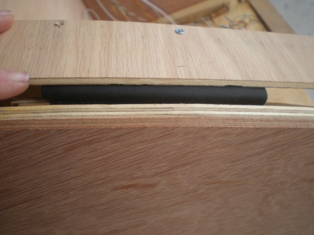

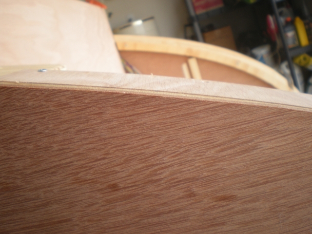

This shot tries to show how well the "skin" follows the curve of the side:

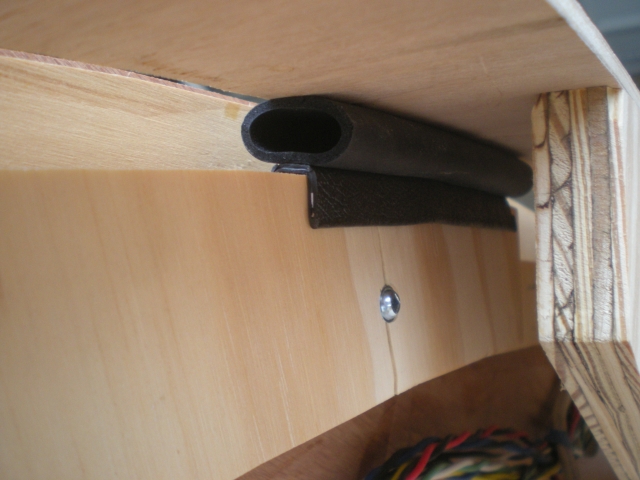

Nice squish on the weatherstripping:
A look at the weatherstrip from the outside:
The gap from hatch to wall won't be nearly this wide. Probably about 3/8" when built.
The next step is back to the drawing board to design the entire hatch. Then build! :twisted: The hard part is done! :chicken:
Thanks for looking, stay tuned! :beer:

Re: CNC Build -- Hatch 4.1
Postby KCStudly » Sun Mar 16, 2014 11:06 pm
Looking very cool. :thumbsup:
It looks like you will end up with about 70-75 deg of opening. I assume you got it to where you are happy with the height of the open hatch(?).
That is a very original seal arrangement. The trim seal seems like a very nice product, IMO. What are your impressions with it so far?
You've got my attention and I'm full of questions. What do you plan on doing at the top and bottom transitions where the seal needs to transition to horizontal?
Posts: 9205
Images: 8116
Postby capnTelescope » Mon Mar 17, 2014 1:03 am
(soapbox) First of all, I want to encourage anyone with questions or concerns about this design to SPEAK UP! If you don't understand how this is going to work, maybe I don't either. The dumb questions are the ones you didn't ask that could have kept me from looking stupid(er). (/soapbox)
KCStudly wrote:It looks like you will end up with about 70-75 deg of opening.
72 deg, according to the dwg. :ok:
KCStudly wrote:I assume you got it to where you are happy with the height of the open hatch(?).
I'm glad you asked that question. :frightened: I ass-u-med it would be so. Thanks to your question, I checked it. According to the drawing and my estimate of the trailer bed height, the bottom edge of the hatch will be 75" (6'3") above ground level. I'm only 5'7" (or at least I once was), so if I don't start wearing Lady Gaga shoes or ten-gallon hats, I'll be OK. :ok:
Which makes me want to ask a question of my Dear Readers. How high is the bottom edge of your hatch when it's open? More? Less?
KCStudly wrote: The trim seal seems like a very nice product, IMO. What are your impressions with it so far?
It's McMaster-Carr 1120A592, 1/4" edge, 3/4" "A" dimension, upper left corner of the page. It looks like choice quality good stuff to me. :thumbsup:
KCStudly wrote: What do you plan on doing at the top and bottom transitions where the seal needs to transition to horizontal?
I'm thinking mitered weatherstrip corners held together with some super-dooper weatherstrip adhesive TBD. I'm still fumbling around trying to draw in a rain gutter along the top. I thought I'd mount the bottom weatherstrip piece a little bit proud of the trailer end, so it could ease the banging of my shins on the trailer. I'd really like to radius the corners so I don't have to miter, but I haven't fingered that one out yet. I'm also thinking about how to use aluminum bar/channel/angle/whatever. I could probably cut Al on the CNC. On teardrop.net's facebook page, Grant shows using aluminum sheet/plate on the hatch spars to fight springback. I'll probably do that. Fiberglass is another possibility for rain gutters. :thinking:
I can see why there haven't been many builders trying this approach. :?

Postby capnTelescope » Mon Mar 17, 2014 10:17 am
Now that I'm working in the third dimension, to put a rain gutter along the top of the galley opening, I've uncovered a fatal flaw in the design of Hatch 4.x. Let's look at the mockup in the open position:
The parts that I called the Galley Spar and the Hatch Frame End Panel come face-to-face in the full open position. This means that any rain gutter along the top edge cannot extend below the plane of the bottom of the Galley Spar. If I can't do that, there's not enough room for the weatherstrip, so there's no seal. Checkmate. :cry:
Hatch 3.x shows some promise in getting around this, so I'm back to that.
Thanks for looking! :beer:
