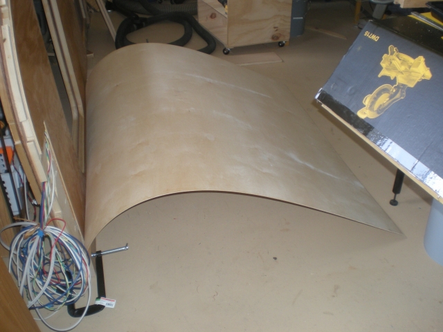

One of the many things rattling around my brain is that one of my Dear Readers asked in their build thread whether pre-coating with poly on a piece of ply that will be bent will affect the bending. I have an answer.
Those of you who have been following my build might remember this picture of me "training" a sheet of ply to skin my hatch with:
Some time after I took this picture, I did a pre-coat of wipe-on poly on the inside side of that sheet. Time passed, the sheet got set aside and forgotten until yesterday, when I got started on skinning my hatch. The ply definitely bends much better the "other" way now. IIRC, I let the sheet be flat while the poly cured.
I'm not sure what the lesson here is. Either the trick is to poly the other side from the bend. or let the poly cure while the ply is bent. Or both. :NC
I'm checking the usual suspects' threads for the original question. {EDIT} You can find the original thread here.
Hope this helps. :beer:

Postby KCStudly » Thu Jul 10, 2014 3:42 pm
Hey capnT, I wonder if there is any chance at all that you might have coated the outside of your trained ply by accident. That would simplify the analysis paralysis. :lol:
In reality it makes sense that the poly makes it harder to bend. It acts just like a glue binding the fibers of the wood together and making them stiffer. It's just that I would expect it to work the other way. The outer fibers need to stretch and the inner fibers need to compress. If the poly side doesn't want to stretch or compress as easy at raw wood, wouldn't you think that the raw side would be more agreeable to stretch extra, rather than compress extra in compensation for the poly'd side?

Postby noseoil » Thu Jul 10, 2014 4:27 pm
Yep, functionally it's added another lamination to the ply. The raw side will swell up around moisture and expand when humidity increases. It will contract if it dries out, works just like a tree. Plywood is great stuff!

Postby capnTelescope » Thu Jul 10, 2014 7:42 pm
Mud.
KCStudly wrote:I wonder if there is any chance at all that you might have coated the outside of your trained ply by accident. That would simplify the analysis paralysis.
Accidents do happen. I'm "pretty sure" I got this one right. :NC
My observation is that ply will bend toward one side easier than the other, given the same grain orientation. Which makes sense, since it is a natural product. And... I did choose that side for appearance reasons. An unscientifically small sample of 1 or 2 sheets seemed to indicate the ply bends away from the "good" side.
KCStudly wrote:... wouldn't you think that the raw side would be more agreeable to stretch extra, rather than compress extra in compensation for the poly'd side?
Yes, that makes more sense than anything else here. We know that wood is weaker in tension than compression. If we pull normal to the grain, wood will split,, but wood will support large static loads in compression. It also makes sense to me that a poly infiltration of the fibers would improve the tension properties.
Now that I've read what I just wrote, I'm going to say "No" to that question. The poly'd layer is stronger in both tension and compression, but the poly'd layer is still weaker in tension, and the raw side is... still raw. :?
noseoil wrote:Yep, functionally it's added another lamination to the ply.
That's close. In the present case, it's only infiltrated the fibers, strengthening the poly'd layer. But there's not a thick enough application to qualify as a new layer. :NC A distinction without a difference.
noseoil wrote:Plywood is great stuff!
I'll go with that statement without qualification.
