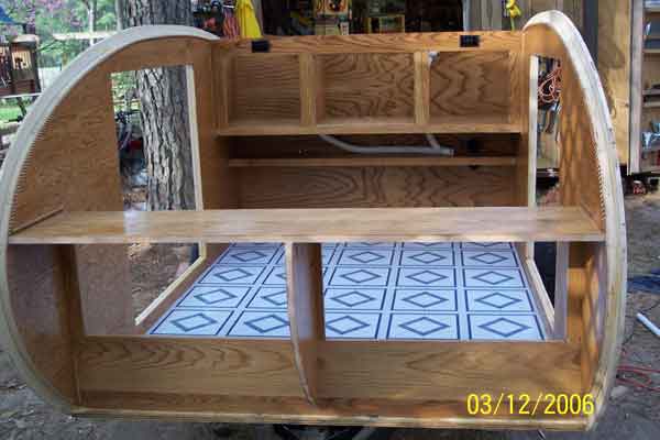

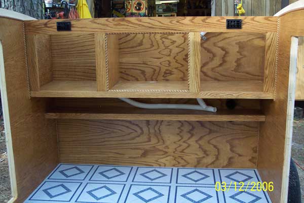

Here's a shot of my interior cabinets prior to the top being installed.
What I did different than most is, I used a single sheet of baltic birch ply for the counter top in the galley and the bottom of my cabinets. There is no step up in cabinet height from galley to cabin.

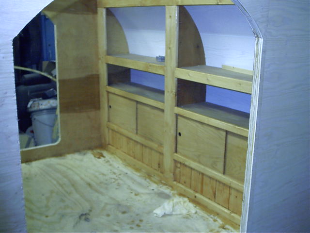

Here is some pic's of mine. At the bottom is a raceway for running wires, mounting a stereo and running AC hoses to the vents.
During construction the wall was blocked for the mounting of the rear cabinets and then pocket screwed and glued to the wall. The front cabinet as well as the rear wall are in dado's in the wall and part of the torsion box.

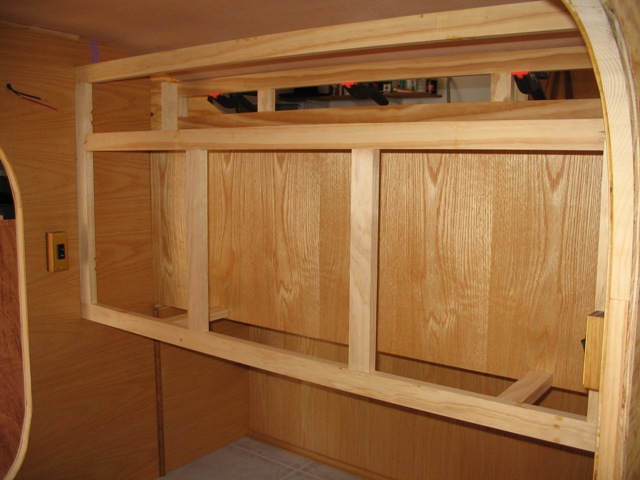

The first photo show the raw headboard cabinet before the ceiling was installed. Both of my cabinets are framed as an integeral part of the tear for lateral and integral strength to the tear.

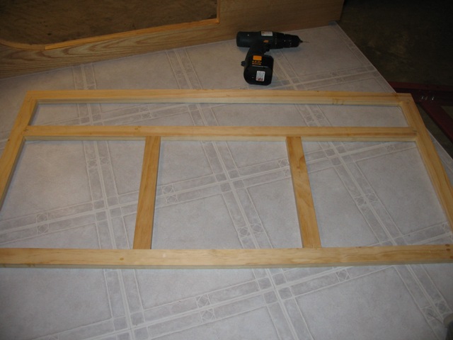

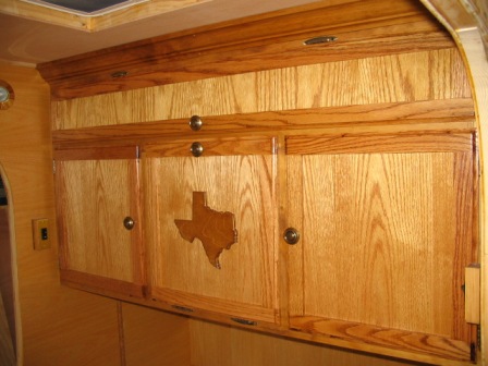

Here's mine. First photo shows the front face, the second when it was attached to trailer with pocket hole screws and finally the finished cabinets.
