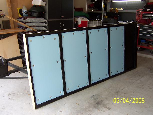

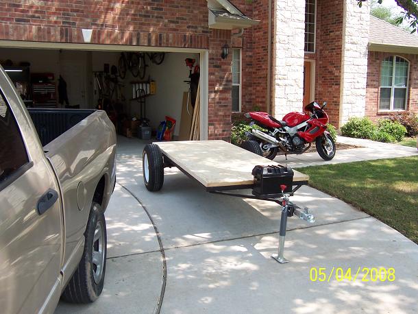

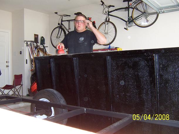

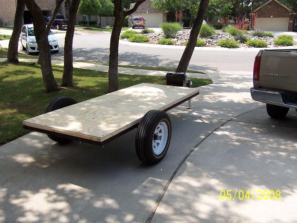

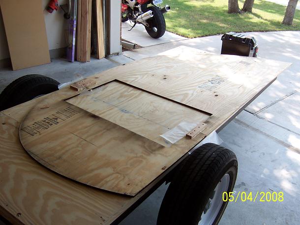

Made some progress today! Yeah the TD has sat for a month or so, but I'm back on it (<edit> 6-6-09 (Little did I know it would sit for another several months!)). I wasn't looking forward to having to move everything outside before working on the TD. Oh well, I did procrastinate and it wasn't that bad. Lets see, the asphalt on the floor had plenty of time to dry, so I prepped the floor for frame mate-age.
Got the insulation on.
The floor is bolted on and ready to go!
I'm gluing up the right side, that I previously lasered out (check out my album for non-stop lasering action!)
Done for now. I had to shove everything back over into my side of the garage. Sarah, my wife, has to clutter up the garage with her car!

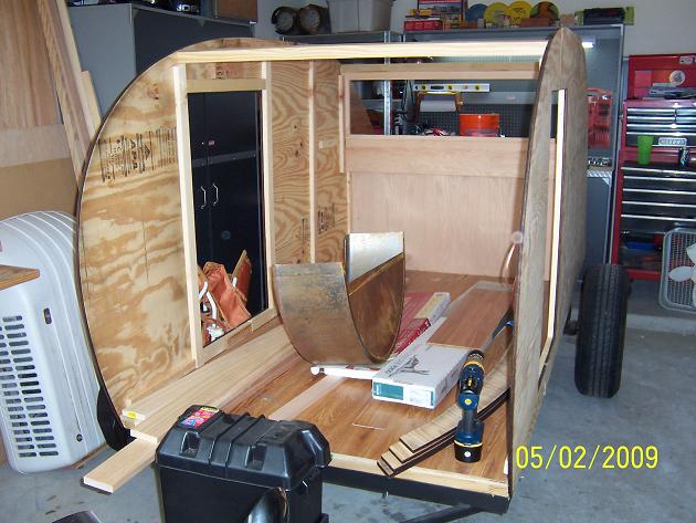

Just thought I'd let everyone know where I'm at. I'm waiting on a Parallax 6730 from http://www.bestconverter.com/ that should be here monday. I'll be wiring my trailer next so I can insulate the walls, and then get the interior skin on. I really liked wlooper89s setup:
But didn't have the $$$ to throw down on a tongue-box...yet.
I'll probably run some conduit or PVC? from the battery box to my galley and make all my connex in there. Galley space is at a premium, so I'll definitely be losing some space, but that's my plan. Here's where I'm at now:

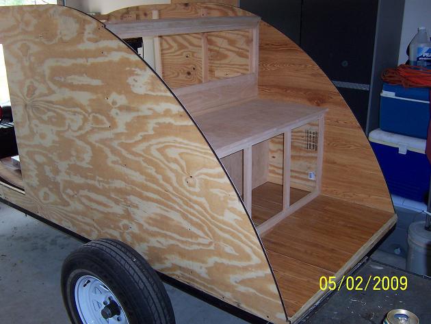

Got the walls on, and the beginnings of a galley. Used the peel & stick for the floor, I think it looks pretty cool. Sarah doesn't like the peel and stick on the galley walls, though. I used contact cement to attach it, I hope it'll come off (relatively) easy.

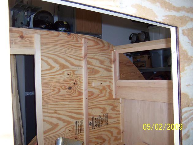

More galley pics. The "window" is supposed to be access to a little pantry for cans and stuff, it'll have sliding doors. Its based on Mike's plans for the "generic Benroy". On the Trailer for Two that I'm building its a heck of a reach, though. I'm 6'3" and it'll definitely be a lean to get in there. Have to think about how to salvage that a little.
Interior pic. Those are the fenders I'll be using, and the other stuff is a bunch of junk that has accumulated in the past while.

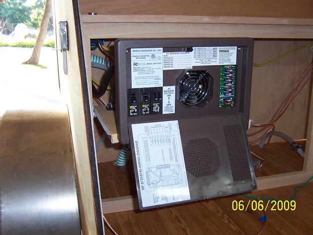

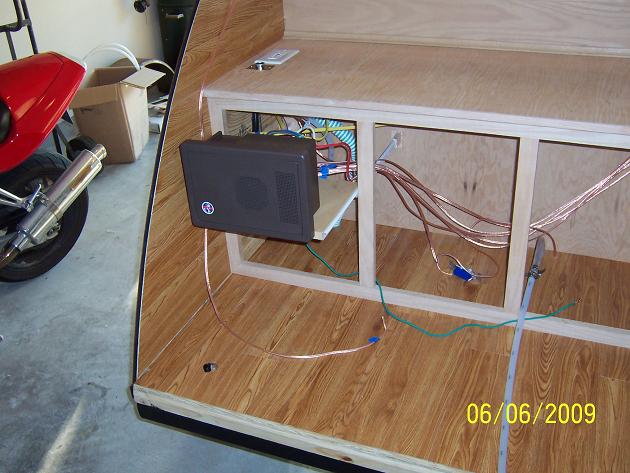

All right, I've been busy like the beaver for the past couple of weeks. I'm 99% finished with my freshwater tank and electrical. Got piccies.
New WFCO 8735 converter. Behind it you can see the hoses going to the water tank below the floor.

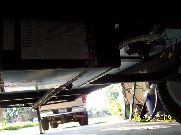

Valterra 9 gallon tank (just barely fit!) with Shurflo demand H20 pump over to the right.
The converter will sit flush up against the cabinet frame. I'm planning on sticking a cooler in the middle so I'll have to move a couple of things around.

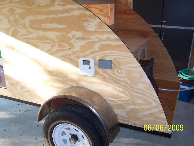

My inlets on the side; water on the left and AC on the right. Hopefully I won't get corn-fused when hooking them up at the campground! :lol:

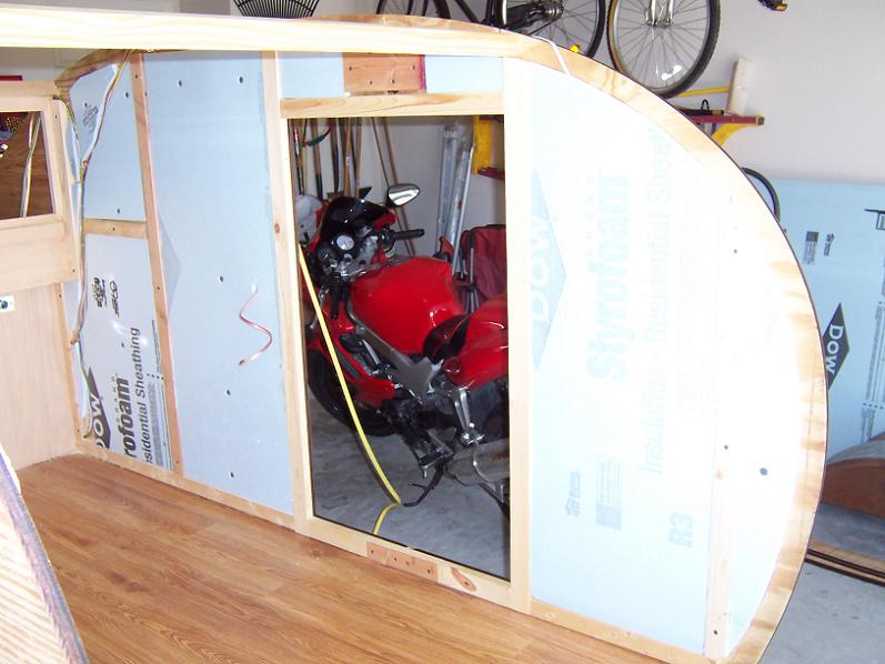

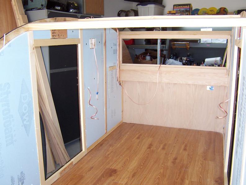

I got a little insulating done...

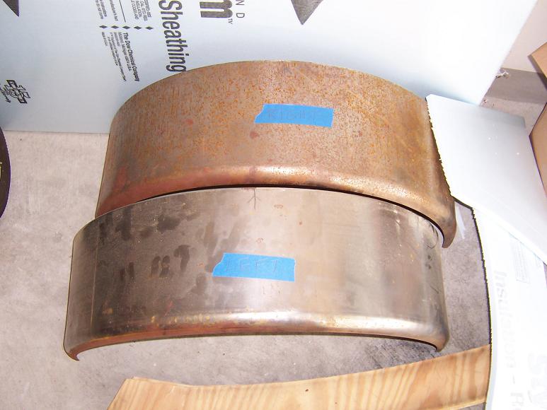

I mounted my fenders with T-nuts before putting the insulation in, no pics of the process, but here they are laying on the floor! Aren't they great?! Actually, I don't know why I took a pic of that...Moving forward

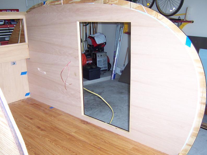

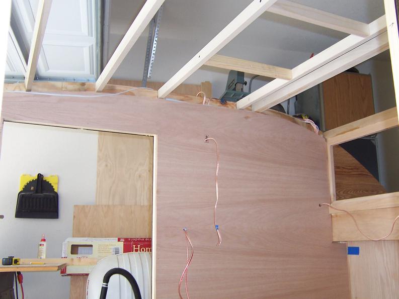

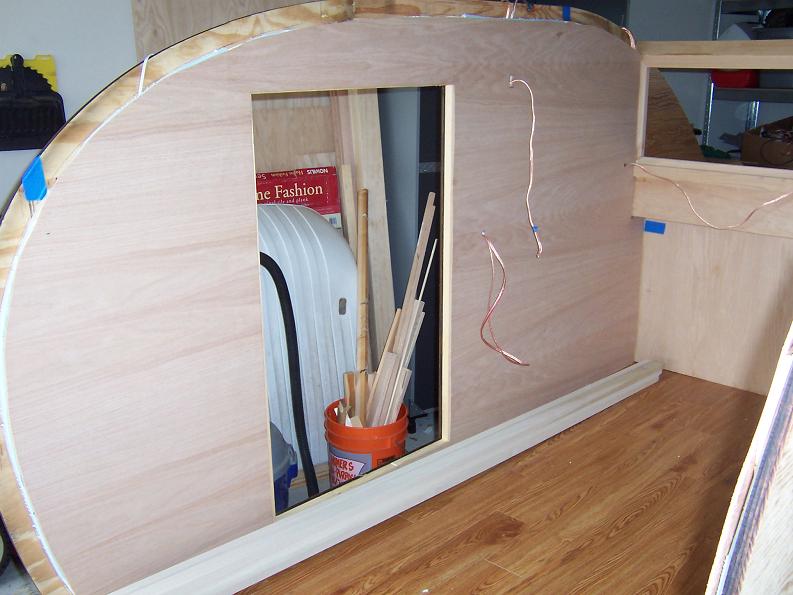

Put in some 1/8" oak bid'ness for the interior walls. Note the blue tape in odd places. They signified 2 things. DON'T Nail Here as well as Nail Here! Only I knew what the placement meant, hopefully I executed that procedure correctly...
Got the sides lasered out, awaiting installation.

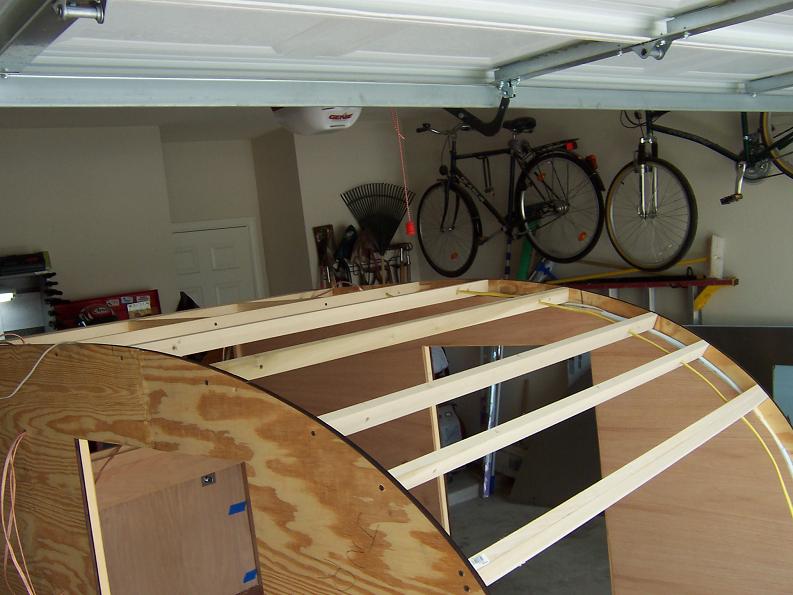

Put in some roof-spars, I used 1X2 poplar.
