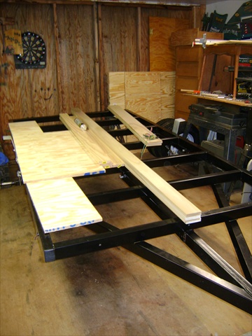

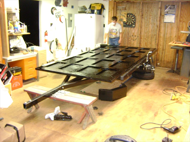

Postby SIXTOTWO » Mon Sep 29, 2008 1:16 pm
Boeden loves to help out.

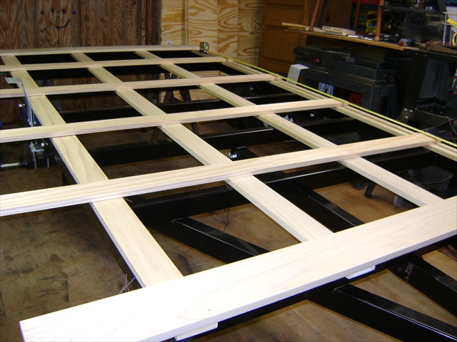

The decking materials are ready to assemble.
Laying out the grid. This was the original plan...it ended up different due to hubby not thinking when he cut the lap joints. haha
we now have 5 support boards lengthwise. whoops! Had to go get another board.

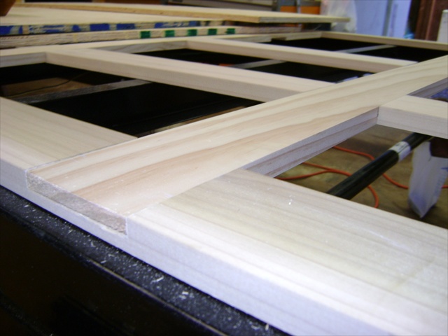

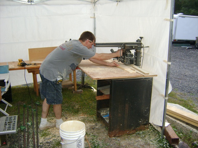

Terry cutting the datos in our makeshift extra garage.
Closeup of joints.

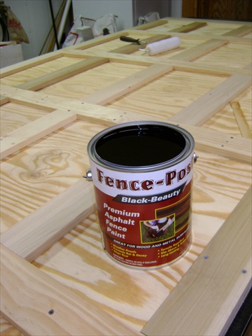

Undercoating for trailer deck.
Almost finished with first coat. Be sure to use good ventilation, this stuff is potent.[/img]

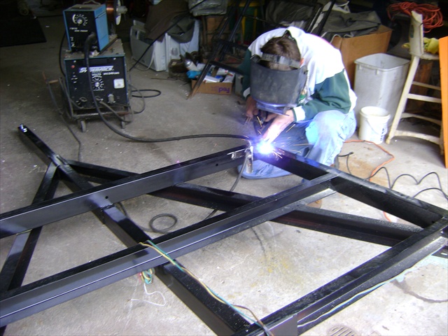

Terry is welding on some corner brackets to attach the deck to the trailer. If for any reason in the future we need to take the box off the trailer this will make it easier as we will have ready access to detach the bolts. :R

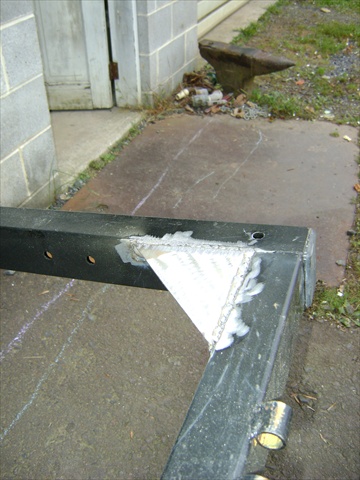

Close-up of corner brackets. There are 6 of them total

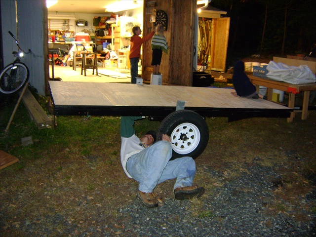

Checking the fit of the deck....it was just a little too big so we had to cut it down...not hard! Next time we measure correctly! :oops:
The Three Stooges trying out the deck fit. Em, Bo and Kev
They'll make a stage outa anything!!! :?
