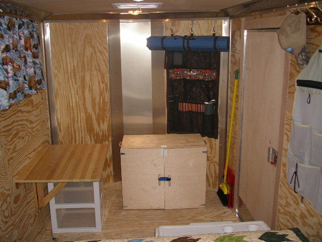

Postby Gonefishin » Sun Dec 20, 2009 7:48 pm

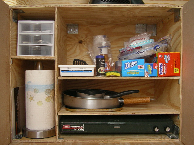

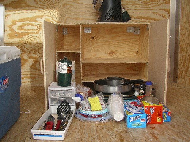

In keeping with the simple and portable theme, it was time to build the chuck box for cooking stuff. It had to be easily movable to the outside, since that's where I'll do 95 percent of my cooking. It also had to serve a function in its chosen location inside, not just take up space. So, I built the box to accept my cooking/eating items easily, keep them very accessible, and still be moved by one person. It's 24" high, 32" wide, and 16" deep, built from plywood. It will also serve as a small table inside, and be secured with straps or bungees to D-rings on the floor. (Those will be added after I lay the vinyl floor)
I opted for side-opening doors because I don't want to cook with my stove close to the box, or on top of the box, for cleanliness reasons. Don't want grease splattered all over and inside the box! I have a folding table to cook on and eat at if there's no picnic table where I'm camped. There is a carrying handle on each side of the box, but not visible in the photo. I also have room to add one more shelf on the right side if I later find that necessary. PLENTY of room!
You may be able to see I still have lots of room inside the box. I'm using about half of the cubic footage inside right now, but I don't want it brim-full and becoming too heavy. It's convenient as it stands now, with room to add a few lighter items. Due to the depth of the box, I have room in front of or behind nearly everything you see. If it ends up being overkill, I can always build a smaller one! :) The drawer on the upper left has utensils. Propane bottles are behind it. Lots of room behind the paper towel rod.
My heavier non-perishable food items such as canned and boxed goods will go into different storage, which is the next thing I'm adding, along with wall storage. Same with extra stuff like propane, utensils, paper products, etc. Updates on the simple, functional solutions to that coming soon!

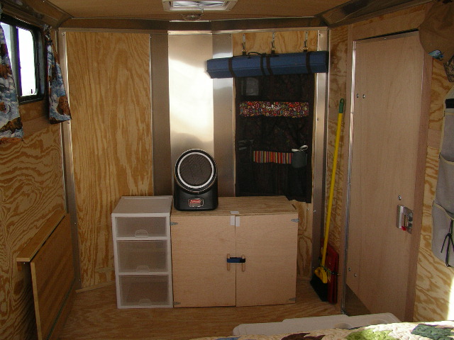

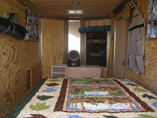

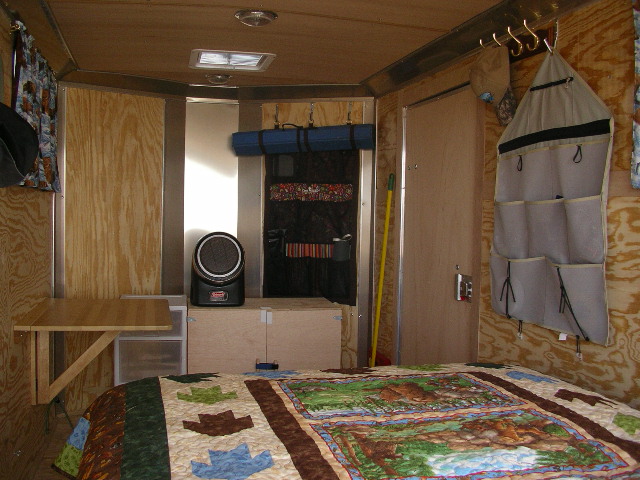

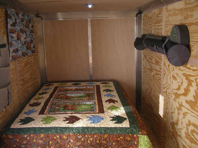

Updated Interior Photos
Postby Gonefishin » Wed Jan 13, 2010 6:06 pm
It finally got above freezing today, and its been a while, so here's a few updated pictures of my interior.
Folding table down.
Folding Table up.
Table secured down. Blue Roll-A-Table, for outside use when needed, just happens to fit snugly on top of hanging organizer. :thumbsup:
Table up. Cooler at foot of bed is secured, and does not block door way at all. Fits perfect between door way and bed, and is accessible from outside through the door without stepping in. Easy to drain out the door too.
Front to back view. Fly rod cases hang snugly on side wall. Still "just" enough room to walk past them to get in and out of bed or exit out the rear doors.
Next up: Floor covering (area rugs with same bear/fishing theme).
A little more storage on v-nose interior wall (hanging again, more storage area).
