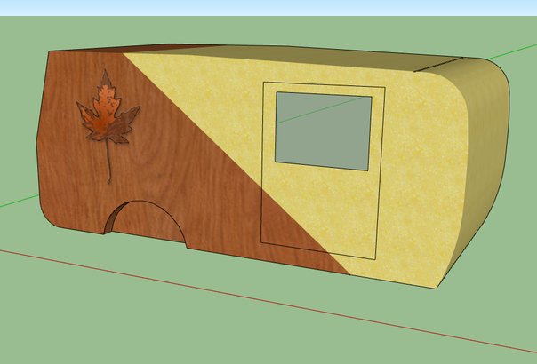

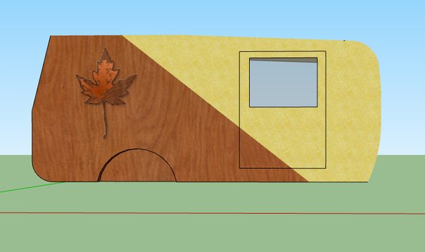

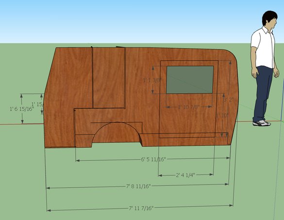

I've been toying with the idea of a Grasshopper profile in an 8' length. I find the profile suits Jeeps well and it seems there is a bit more storage available over what a traditional 8' tear profile offers.
I'm still learning to work with Sketch-Up so most of the dimensions are out a bit and interior elements are bleeding through the exterior wall, but it should give a basic sense of size and what I am shooting for.
I do have a full size Benroy profile template cut, but still find myself leaning towards the GH profile. As a first build I don't think I am ready to be creating oversized ply sheets (ala Steve Frederick). Sticking to 8' only has me giving up some things I consider 'nice to have' vs need to have as well as keeping the budget reasonable.
Anyhow, I would appreciate any feedback or insight anyone has to offer up, it's still too cold up here for sawdust, but as soon as spring arrives I want to begin a build of some sort.
Thanks in advance,
Burke

Postby tinksdad » Wed Jan 27, 2010 12:32 am
You may want to widen your door if possible. The door on my Itty-Bitty is 24" wide and it's just marginally acceptable to get in and out.
Edit: Ooops.... on second look, I mistook the window width on your design as the door width. My bad.

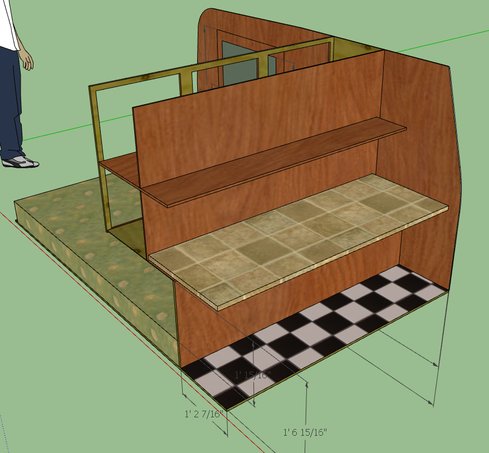

Postby aggie79 » Wed Jan 27, 2010 9:54 am
The grasshopper profile really looks good!

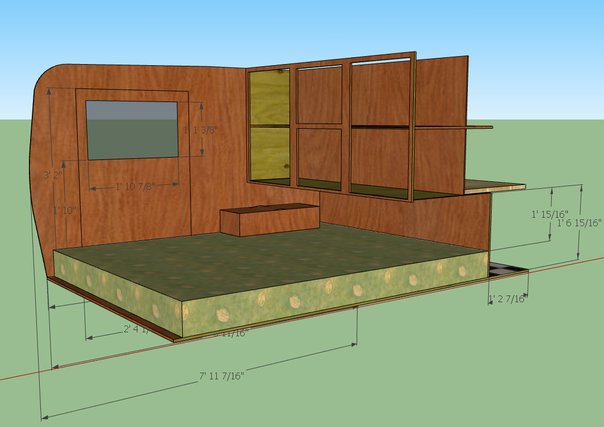

In my teardrop (still under construction) I too have about 19" clearance between the floor and the bottom of the interior cabinet. With a 6" mattress, I think that clearance may be a little tight. It's probably okay for feet, but if the interior cabinet has much depth, it is probably too tight around the legs and knees, especially if you toss and turn while sleeping like I do.

Postby bve » Wed Jan 27, 2010 8:35 pm
tinksdad wrote:You may want to widen your door if possible. The door on my Itty-Bitty is 24" wide and it's just marginally acceptable to get in and out.
Well you made me look. I thought crap did I overlook that, do you think 28" should be ok?
aggie79 wrote:The grasshopper profile really looks good!
Thanks, you have an epic build going btw, I've been watching all the way.
I agree I don't think the interior cabinet clearance is going to be enough, I took a tape to the Benroy profile set up beside the matress for the tear and 1' will be toe touching I think.

Postby Greg M » Wed Jan 27, 2010 9:53 pm
The only piece of advice I'd add is to be careful of the tight front radius. I went a bit too tight on my Grasshopper inspired design and had to use that special bendy ply to get around the curve.

Postby High Desert » Mon Feb 15, 2010 11:09 pm
any updates or new thoughts on this one Burke? I like your thinking on the 8' length.

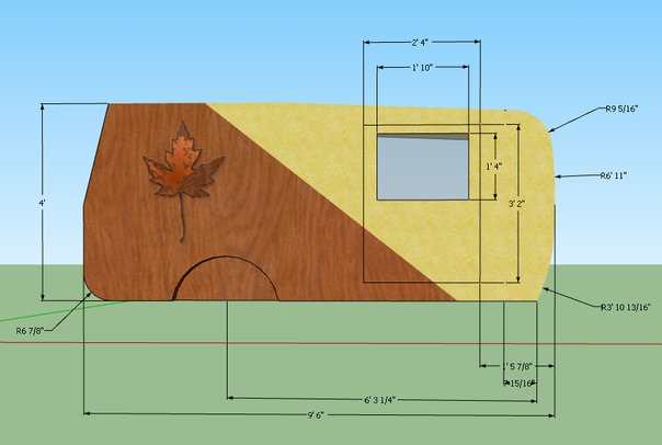

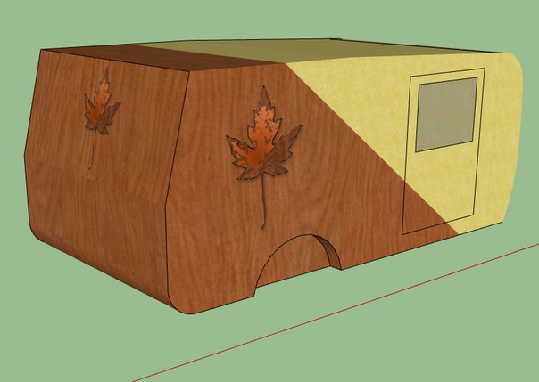

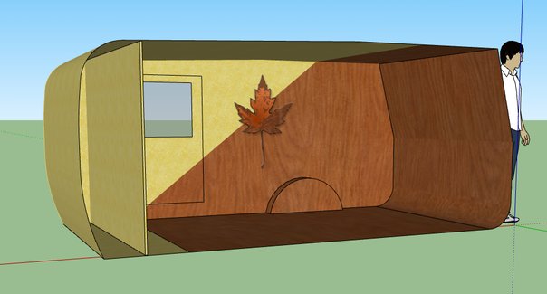

Postby bve » Tue Feb 23, 2010 10:05 pm
After finding the 8' wouldn't hold a 'decent' sized cooler I took another look at going longer, 9'6" is where I am at now. As much $$$ as I'd save with an 8' I think I'd end up paying for in satisfaction - cutting an 8' Benroy profile and laying it along size a queen mattress was revealing in that respect.
Going 9'6" in addition to allowing room for a real cooler also should accommodate some storage in the nose.
I need to be weight conscious given the 2000# tow restriction of my Jeep. The walls are planned for glass & epoxy over 3mm outer and 3mm inner skins with a 3/4" frame. I'd double up the outer roof skin though.
The idea behind the maple leaf is that it's an inlay of different woods/stains - or more likely an overlay of veneers. There is a name for the tear lingering behind the maple leaf, but I'll reserve mentioning it for now.

Postby High Desert » Tue Feb 23, 2010 11:30 pm
Looks sharp Burke. Since seeing your 8' idea I'd been playing with the sizing too and coming up with similar results lol. Things would allllllmost fit. I also like your thoughts on wall construction. Should be light and still have some R value.
I didn't see mention of it but from the shallow recessed wheel wells I'm guessing your design is five wide on a 4' frame?

Postby bve » Wed Feb 24, 2010 2:43 am
Thanks for the compliment Shaun.
It's too bad 8' is not quite enough room, before considering an 8' design I had looked into over-sized ply - the thinest I can get is 1/2" and the cost is not worth it at about $150 a sheet. I tried 8' to see what it would allow for, but when all is said and done it just isn't quite enough.
The frame I will be using is 47" wide on the rails, I do have flex-ride stubs so I don't have to recess the wheels, but I also don't really want the track to be much wider than the TV - so yeah 5' wide on 4'

Postby mikeschn » Wed Feb 24, 2010 4:30 pm
Burke,
It looks good, but you'll have a hard time bending plywood around a 9" Radius. Make that radius bigger, and you'll be much happier...
