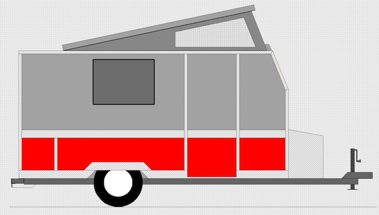

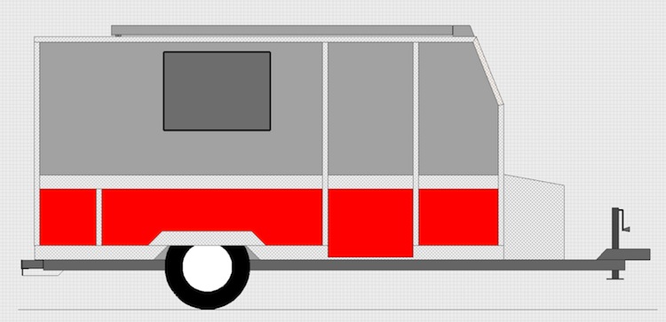

This is the start of my build thread. The TTT is a substantially reworked version of Andrew's Compact III that I have described in preliminary terms elsewhere.
At present, I am refining the design. Here is the profile with a new color scheme that I will carry into the interior. It has a pop-up reminiscent of our old VW Westfalia Camper, but with a powered linear actuator for maximum coolness and minimal effort.
Top in the down position.
Top in the up position. The pop-up sides and front will be light-weight, UV-resistant cloth with screens and rollup covers on the inside.

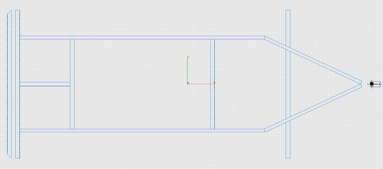

The chassis comprised of 3x1.5x0.125 box section longitudinal and tongue members and 2x2x0.125 angle transverse members. The bumper is also made of angle section steel.
The length of the longitudinals is 117 inches and the width of the transverse members at each end that will be bolted to the body is 71 inches.
The longitudinal, tongue, transverse, and cross members are all on the same horizontal plane in order to keep the floor height above ground as little as possible.

Postby S. Heisley » Wed Oct 06, 2010 8:38 pm
Color is a personal preference; but, I liked the blue-green better than the red. Red says, "Over here! Look at me!" Blues and greens are more subtle. They say, " Ahhhhh...." :)

Postby down under tech » Wed Oct 06, 2010 11:37 pm
Hi Mike: Candy Teal ??? Is this what you are talking about? Teal on the bottom and white on the top? That would look good.

down under tech wrote:Hi Mike: Candy Teal ??? Is this what you are talking about? Teal on the bottom and white on the top? That would look good.
Hmm. Looks like there may be some reasonable choices in teal. I would like to pair whatever accent color I chose for the lower panels with silver grey for the upper panels in order to complement the diamond tread plate trim.
I wonder how well this paint will look if applied with a roller rather than a spray gun. Have you had success with this on wood?
