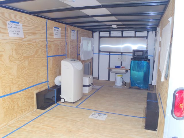

Postby pmspirito » Tue Jul 19, 2011 7:18 pm
Please click on my photo album for construction photos.

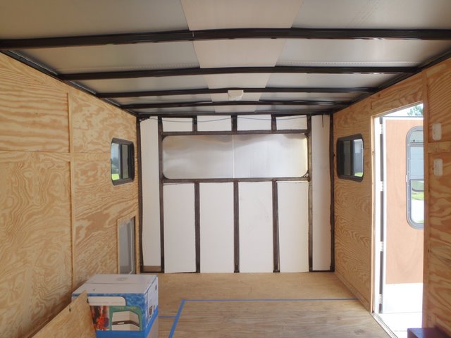

The first interior photo shows the trailer as I recieved it. Removing the interior plywood on the front wall reveils the framing the factory did for my 18" X 60" picture window.
On the street side of the trailer is a 24X24 inch cargo door located below the window. This will open for access and storage under the kitchen counter.

Postby pmspirito » Wed Jul 20, 2011 3:03 pm

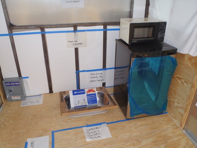

I have added several photos to my album. They show the completed appliance and cabinet layout. Click on my album to see more details.

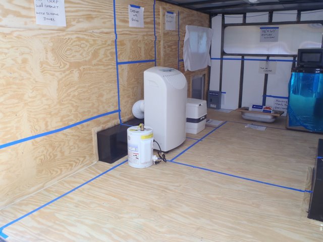

I purchased the A/C several years ago when Florida was having a run of hurricanes. I was operating the house on a 6,000 watt portable generator and it was hot. I bought the A/C in desperation.
We were amazed at how well it worked. I put it in the living room hoping for the best or anything to help. I few minutes later I realized it was getting cool in here.
Since then we have not had any storms. I run the A/C and the generator twice a year. Once at the beginning of hurricane season and once at the end.
I am exhausting the hot air thru the floor so as not to have any openings on the outside walls of the trailer.

Postby pmspirito » Thu Jul 21, 2011 6:23 pm
I have relocated the hot water heater from under the sink to the storage area under the bed. This change frees up more useful space under the galley counter.
I made the depth of the counter deeper to accomodate a 10w x 13h x 40l 20 gal grey water tank. The tank is on the right side behind the fridge.
