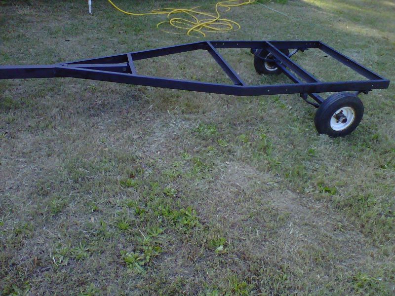

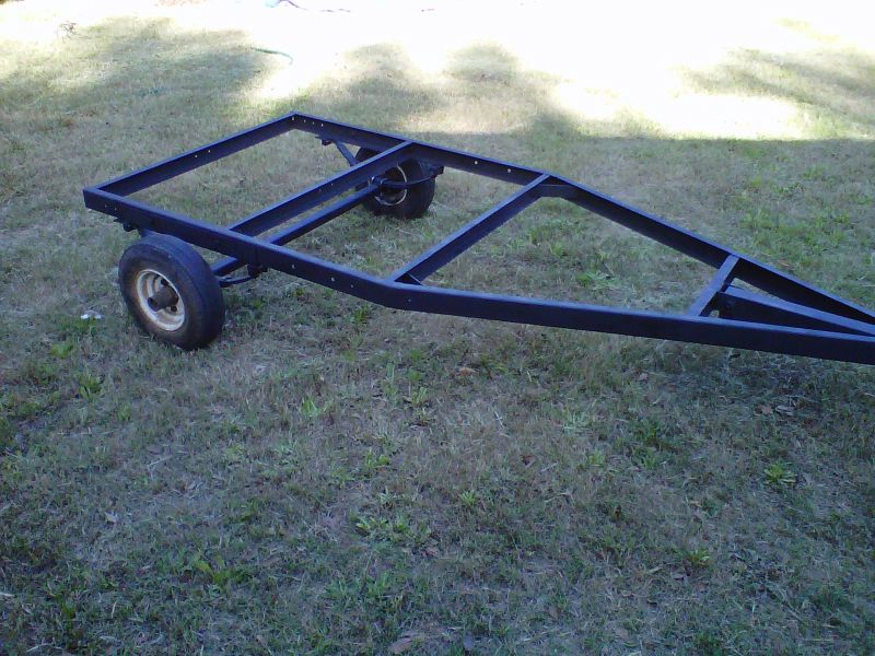

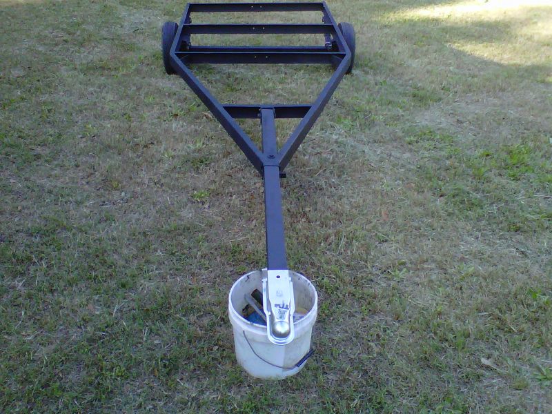

I didnt get a picture of the original trailer but just to let you know it was a really rusty green boat trailer i started with and after hours of grinding and sanding heres whats left.
I sprayed the whole trailer with two coats of rustoleum flat black, then two more coats of rubberized underbody spray. :ok:

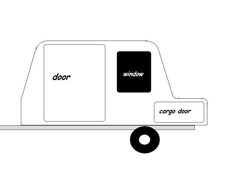

here is the basic shape im going to end up with not really traditional at all .
It ended up being a design on the fly build :lol:

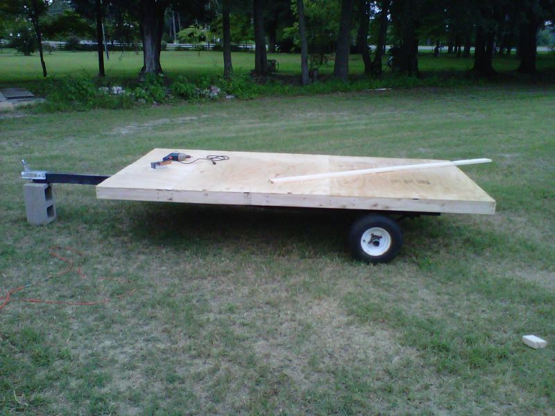

Postby jbyrd » Tue Aug 30, 2011 8:44 am

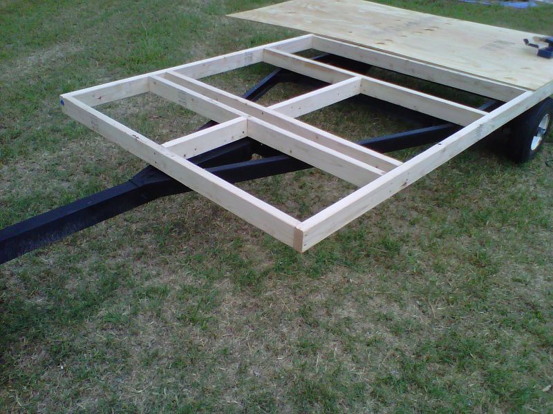

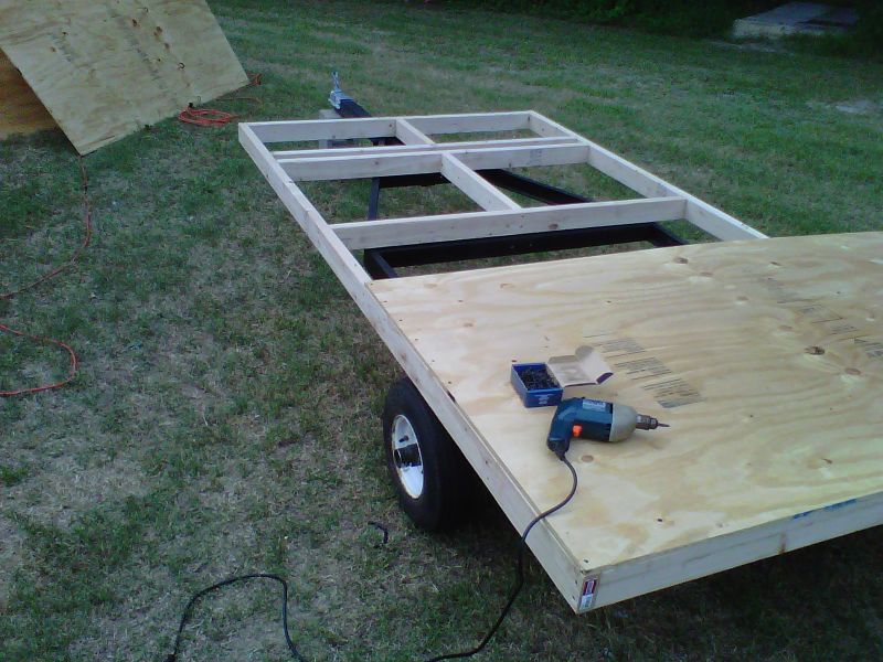

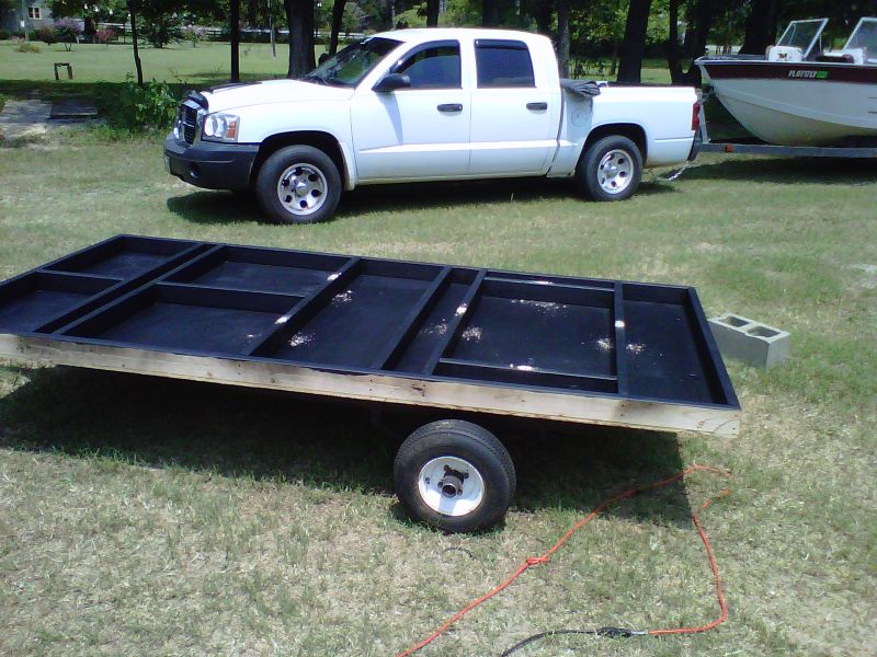

Ok so here are some more pics of my progress, started the floor with 2x4 construction and topped with 1/2" ply, I am concerned about the wieght but not tremendously as my tv for this trailer is a 4 door dodge dakota.
I used tsc fence and barn paint 2 coats, then a coat of rubberized underbody coating and the attached the floor to the frame with 12 5" carraige bolts.

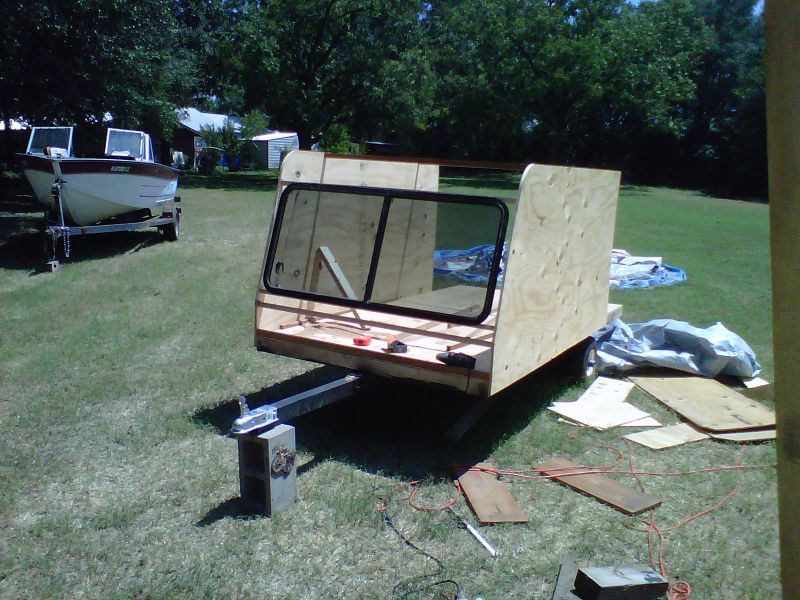

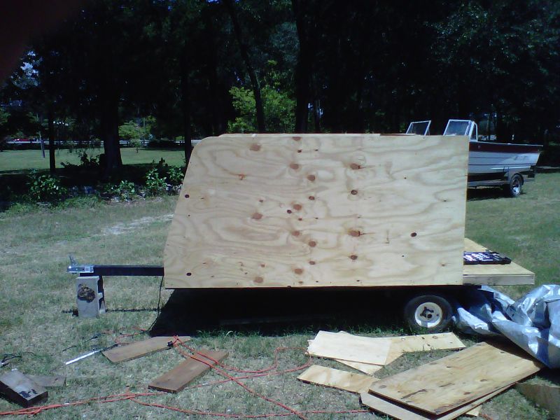

Postby jbyrd » Wed Aug 31, 2011 8:44 am

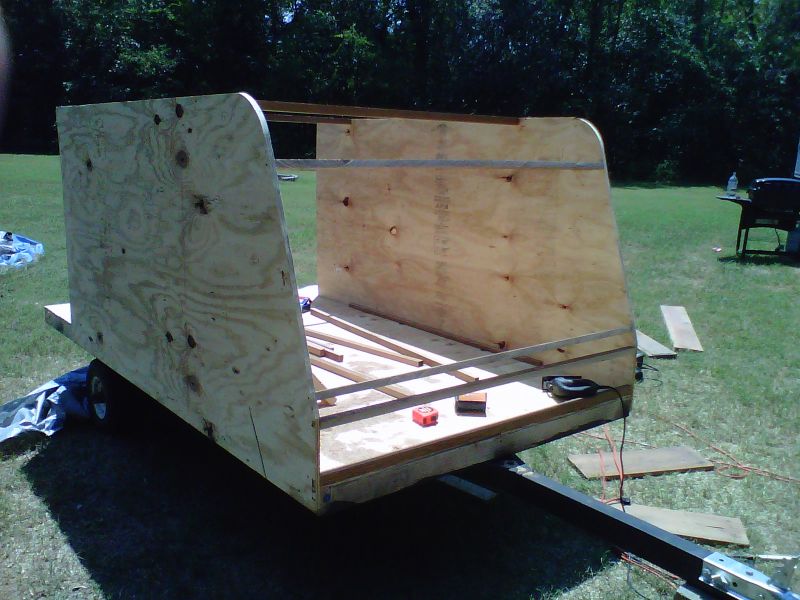

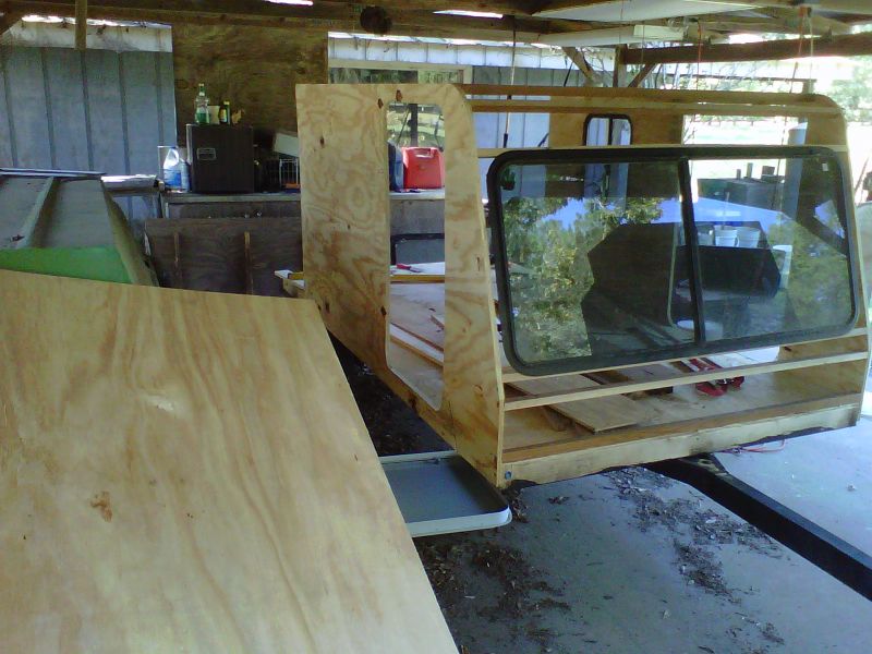

As promised more pics. the walls are started.
all that's done so far is the front profile cut for both walls
Here im test fitting the GIANT front window im using. (which i got for free, in fact i got all my windows for free) from a buddy that was scraping out a 53ft fifth wheel.

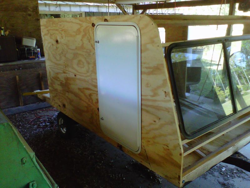

Postby jbyrd » Thu Sep 01, 2011 4:47 pm

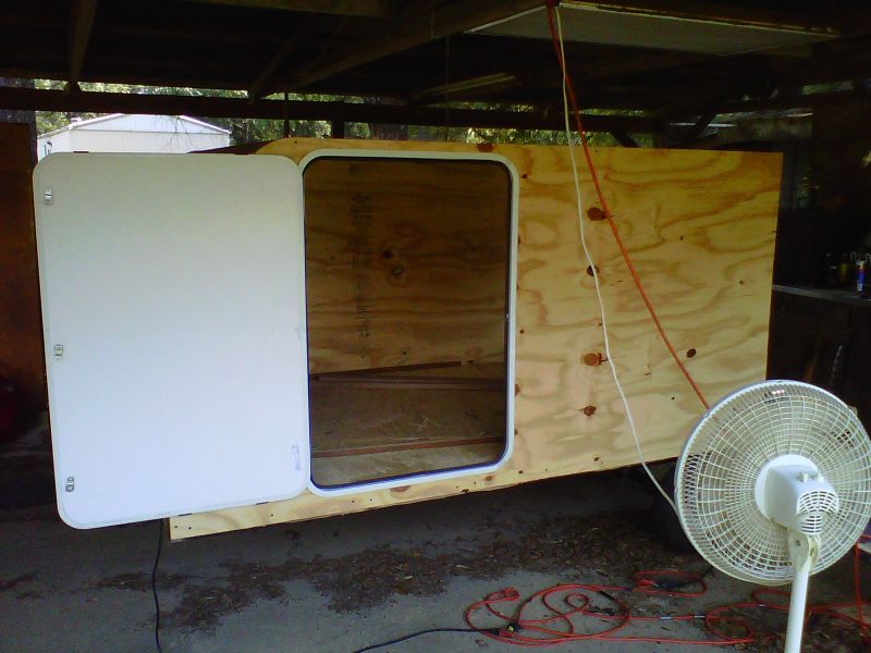

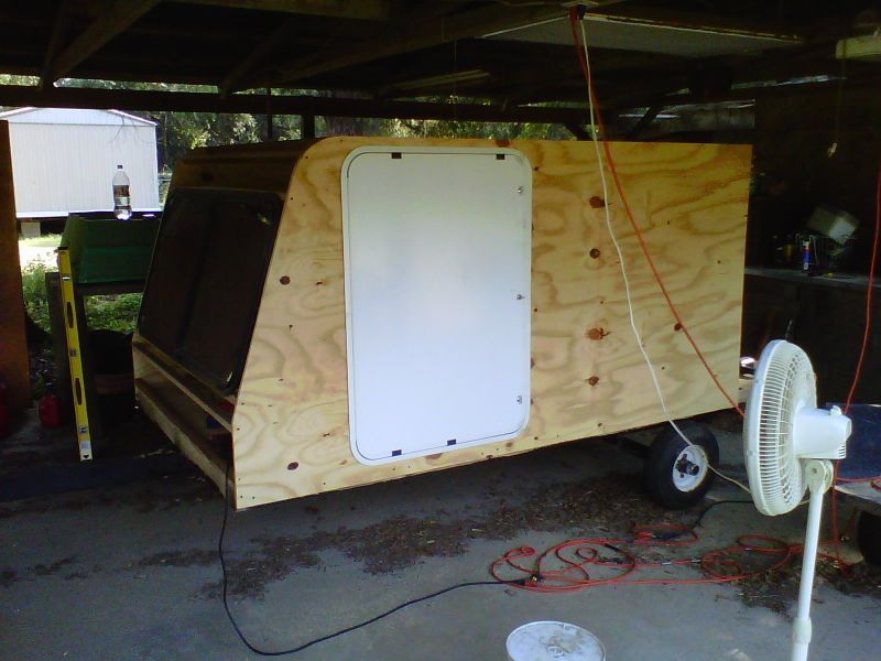

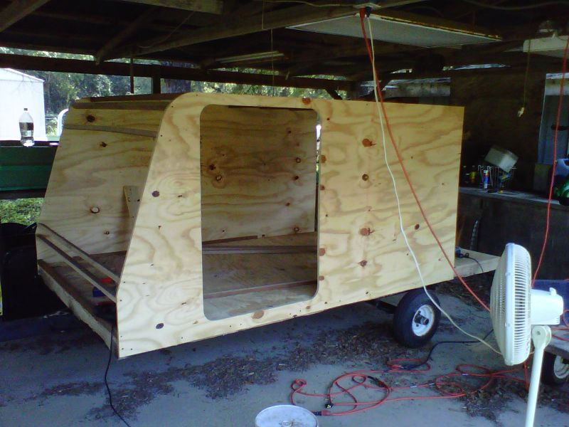

ok time for some more pics :D by the way my walls are being built out of 3/4 ply.
Also I have been struggling with a name but I was thinking about "room with a view" on account of all the windows I am using and the giant front window. What does everybody think? Seriously i need some feedback on this, Please.
I got a his and her side :lol: I get the big door for my overgrown butt and she gets the lil door
I chose to go with cargo doors because they were big enough and cheap (50 bucks) for both with shipping.
