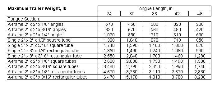

Some of you will remember that after Dave Nathanson's tongue collapse, I tried to come up with a tongue strength guide, though it never got very far.
So I am delighted that Adam ('eski') has pointed me to the Australian small trailer design rules - these contain a rule on 'drawbar' (tongue) strength that is dead simple to use and I have made up a web page with all you need to check your planned or existing tongue:
How strong does my tongue need to be?
If you want a sneak preview, here is a table that shows the maximum trailer weight (GVWR, not bare weight) for typical tongues sections and lengths. The web page shows you how to calculate the exact answer for your particular trailer.
If you are Mike, you'll notice that your favourite A-frame 2" x 2" x 3/16" is good for a 2,300lb GVWR trailer with a 36" tongue. Whereas some other people here may have a nervous look to them.....
Incidentally, I've done the calculations for Dave Nathanson's trailer details and his trailer tongue had only 71% of the strength required by these rules - so that more or less supports the rule.
All comments and suggestions gratefully received.

Postby surveytech » Mon Apr 10, 2006 3:56 pm
Heres's something interesting.
The TSC trailer has a single 3' long tongue that is 2" x 3"x 1/8" and has a stated capacity on the sticker of
GVWR = 1500 LB
GAWR = 2000 LB.
looking at the chart above the maximum capicity of that tongue is 1240 lbs. at 36 inches long.
Do you think that means that Carry-ON is putting too light and tongue on their trailers?
Hey I am just curious.
Walter

Postby angib » Mon Apr 10, 2006 4:58 pm
surveytech wrote:Do you think that means that Carry-ON is putting too light and tongue on their trailers?
Well, it would seem that the Carry-On trailers wouldn't meet the Aussie rule.... Actually I did a quick number-crunch on one of the Carry-On trailers a while ago and satisfied myself that while the tongue is quite beefy, the two angles it's attached to are not - they are likely to fail well before the tongue itself does.
Actually, I think this Aussie rule is pretty severe, but for amateurs that may not be a bad thing. When we've all been building trailers for 20 or 30 years, we'll be able to trim down the tongue strength quite a bit.
I hope Cary posts here, as I suspect the Camp-Inn wouldn't pass this rule either - though I don't have the spec of the frame members, so I don't know for sure. From what Cary and his customers have said, I doubt there is any problem with the Camp-Inn and so it is an example of where a general rule doesn't cover all cases.
Andrew

Postby Cary Winch » Mon Apr 10, 2006 7:08 pm
Andrew,
Ok, I will post on this. Pretty simple, the load calculations used in that chart have no bearing on teardrops designs. Purely for utility trailers for which I agree they look correct. The load on a utility trailer does transfer to the tongue much more substantially. This is what I always have been saying about teardrop frames. They are not utility trailers and using info for building utility trailers will always garner you a extremely over built and heavy frame on a teardrop. The tongue does not see those kinds of loads on a tear. The tongue weight would have to approach those figures not the total weight for that to be correct.
A utility trailer has to support it's full weight at all points of the deck. If you put the full load all the way to the front of the deck (you know someone will) it will put ALOT of load on the tongue. This is why the chart makes sense to me. Now, a teardrop's primary weight is fixed to the station locations of the components used in the body. So, all you have for variables is loading inconsitancies of equipment.
The tongue on a teardrop has to do two things. Support the tongue weight while travelling down the road and drag the axle down the road behind it. I believe the straight pull capacity of two 2 x 2 angles is near 10,000lb. So, you won't pull the tongue off if it is welded on proper, even at the angle of a a-frame. I would figure probably 2Gs worth of shock on the tongue would be safe, correct me if I am wrong there it is a WAG. That being said a proper tear that weighs 1,000lb would have 125lb tongue weight. So, it would only need to take about 250lb. The chart shows that you would have to get out past 4' of tongue on the 2 x 2 a frame for it to get close to limits. Throw in extreme loading variables of lets say 50% and your tongue length would be pared down to something like 3' (like ours)according to the Aussie chart. This is where I see the chart being usefull if this is kept in mind.
Once again I am sure I am doing my rambling, my apologies. I might not even being making sense, I do that alot.
Once thing we did different in our teardrops is we built in flex. The body to frame joint is allowed to flex in front so that the tongue has some bounce. That seems to do a super job of absorbing road shocks. There is no sign of wear and tear on our frames, and we have done some pretty exciting stuff (well Craig mostly).
I wasn't aware of Dave's tongue failure. Can't comment on that.
Cary
