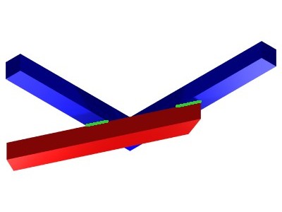

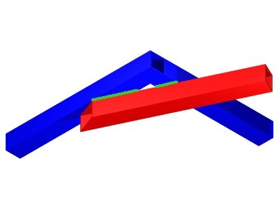

Postby angib » Thu Oct 08, 2009 5:28 pm
(I'm not putting myself forwards as some sort of judge - just one more guy stating his opinion...)
I can't see any problem with the A-frame on that trailer. I disagree with Madjack's desire to see the A-frame go back to the first cross-member - that serves no structural purpose that I can see. It looks to me like there is 6-8" of overlap between the A-frame and main frame and that's quite enough - though I wouldn't want to see much less.
If I had to find fault, I would be happier if the inside face of the A-frame overlapped the side rail a bit more.
So, looking from underneath, instead of the three green welds between the red A-frame and the blue side/front rails now:

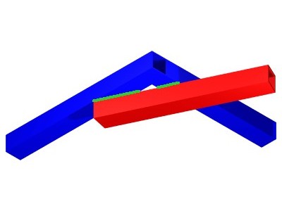

....there would be space for all four green welds:
This would help avoid a joint that is a bit weaker than the parts it is connecting together, but what's there in the photos is likely quite strong enough.

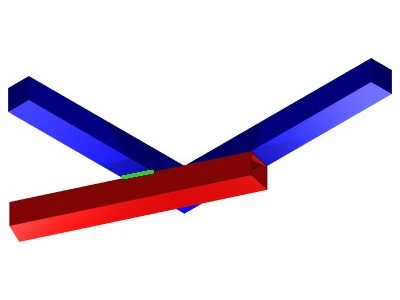

And just incidentally, the Australians forbid the use of welds where the A-frame crosses under the front rail of the frame - they say the welds are stress raisers that cause cracks. I think that may be true of the welds that run across the A-frame tubes, but I would keep the ones that run along the A-frame tubes. In this design, the welds across the A-frame tubes are the ones on top of the tubes that you can't see in these views.
