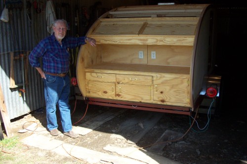

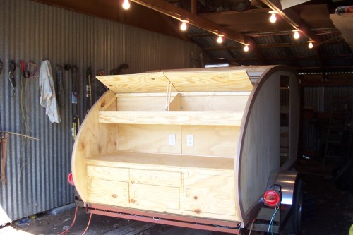

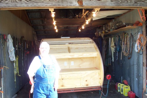

Postby Dulcimer Man » Wed Feb 18, 2009 9:41 pm
Finally got pics of my camper.

Postby aggie79 » Fri Feb 20, 2009 2:04 pm
Looking good and look forward to meeting you at one of the upcoming gatherings.
(My wife and I'lll be the ones in a tent until LCG IV.)
Postby Miriam C. » Fri Feb 20, 2009 5:50 pm
:applause: :applause: :thumbsup: Looks great! There is just the slightest chance we will see it in Louisiana. :thumbsup:

Postby tinksdad » Mon Mar 09, 2009 9:47 pm
looking forward to seeing you again and the new tear at LCG IV.
If imitation is the sincerest form of flattery, although I haven't added it yet, I am copying your side curtain arrangement on "Itty-Bitty". I took enough pics at LCG III to make sure I get it right!!

Postby madjack » Tue Mar 10, 2009 8:17 am
Heyya Buck...really coming aling with the new Td...looks good...we'll seeya and Mrs Buck(and the new TD) at LCGIV.....

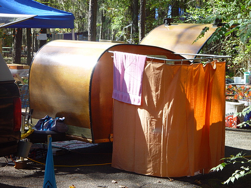

Postby fireaunt » Tue Mar 10, 2009 12:41 pm
and How did his side curtain work? :pictures:
fireaunt
Posts: 691
Images: 38
Location: Friendswood TX
Postby tinksdad » Tue Mar 10, 2009 4:10 pm
fireaunt wrote:and How did his side curtain work? :pictures:
It was a simple (see note) EMT frame that had pivot points where it attached to the side of the tear. It would lay flat against the side when traveling. There was a turn fastener at the bottom to keep it from banging in and out while on the road. It was held in the upright position by a simple centrally located prop rod that laid alongside the mattress while traveling. Shower curtain hooks and some material to close it in. Yes my head would be above the top while using it; but I really don't mind if people see my head and maybe my shoulders while I get dressed. Just a little more convenient than trying to put on my pants inside the tear.
Note: I say "simple" because, like his, mine will need some compound curves to clear the fender in the down position. Now I need to find the hardware that was used on the Puffin2's outside shower curtain frame.

Postby mikeschn » Tue Mar 10, 2009 5:08 pm
Oh I like it... lots of nice features...
I like the lid on the top storage too...
