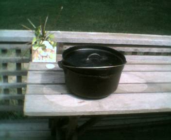

Postby Miriam C. » Mon Sep 11, 2006 2:17 pm
Rocky
Might help to turn upside down. I put coals under and on top and inside. The top is the best seasoned. the bottom is good, but could be better. The sides look blackish brown. I will try again.

Postby Miriam C. » Mon Sep 11, 2006 7:47 pm
TDN, you are so right. I guess It wasn't as bad when I was young. We lived in an old farm house with all the windows open and the fans going. We also baked something every day. That was how we warmed the kitchen in the morning. We also stuck the pans back in the hot oven after cleaned. My former mother-in-law used soap on all her cast and they never stuck.
Coreyjhen, I don't know a soul with a turkey frier but putting oil in it and heating it might work too. I think I sense a fish fry coming on. 8) This winter I wil put some more in the fireplace. This is a bad time of year for it.
