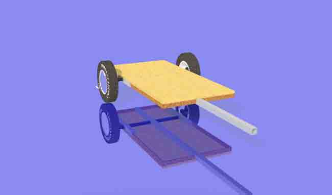

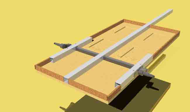

That does look familiar but I don't remember anyone on here building a trailer without a frame. I thought it was the way I was reading it at first but I went thru it a few times to be sure what he was saying. According to his description, his tongue and springs are bolted directly to the wood frame work, there is no frame under this trailer. If that is true this guy is dangerous!

" Holy $hit and what a ride" Nightimes? Gimme a break!!! Had to laugh at your saying typed in right after your comment this trailer is as I quote "dangerous"! The trailer nor the guy is dangerous. If the unit was built well enough, the manner it was secured to the tow frame and axle, its just another way to build a teardrop. More interesting the trailer could as safe as the HB and all the other bolt together trailers now being hauled around, less expensive and weigh less! Consider the fact that one of the best known and a highly respected British sports cars, the Morgan, was built on a wood frame. I haven't seen the plans on this trailer and don't know the builder but if it was designed properly it WILL and does, work! If this guy was smart enough to think of this and build one, maybe two, has it registered and has used it, I think he may change the approach of backyard Teardrop building! I think he has more on the ball than some of the folks building their own trailer considering some of the questions they have posted. My hats off to him! But my opinion is that of a teardrop builder who has never built a teardrop although I have enough years, grey hairs, scars and knowledge in woodworking and construction to know this will work !!! I'd give him a thumbs up but those silly little $hits on the left are silly little $hits---

I am kind of torn on the need for a frame. I agree that what we are building is very lightweight but on the otherhand.... One thing that comes to mind is, here in the central US, we sometimes have potholes the size of VWs after winter scraping and salt. Hit one of those going 70 MPH with a wooden frame and I'm not sure you'd do too well. I have bent steel wheels before by hitting potholes. I can only imagine that it is worse the farther north you go. That's one of the reasons that I opted for the lighter HF frame. I figured that, otherwise, one day I might end up dragging safety chains and splinters down the road if I didn't. Althought, I didn't see the need to have a 1800# trailer for a 600-900 camper. It seemed like it wouldn't handle properly due to it not being suficiently loaded. Just my 2c worth but I feel better with overbuilding especially because it's not just your life and property we're talking about but everyone's around you.

I'm afraid I'd be very leary of not having a frame under that here in PA. I've seen small trailers tortured on our roads, It seems to me that would put a lot of stress on the wood where the bolts go thru. I can see where it might work ok in the pics BufordT posted but I don't think I'd like it that way. It's a little hard to be certain, but it doesn't look like he used any suspension either (if he did the fenders are going to part company with the trailer at the first bump, no clearance) which is also going to increase the jarring and add stress to the works.

On the subject of building in wood only, I'll repeat what I've said before: of course you can build in wood only - you just have to engineer the design to suit the material. If you can build a wooden aeroplane, a wooden trailer seems really simple.
