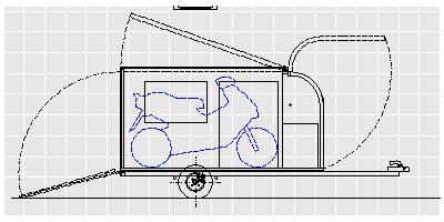

Welcome. I'm no use to you as a builder, as I'm on another continent, but I have a design that is almost what you're looking for. This is a low-riding trailer I did for a Brit that races scooters:
Before anyone gets confused, it's a metric design and those grid squares are 250mm (that's 9.84").
Sounds like you'd want it without the front galley as the 'cargo hold' is only about 6'6" long as shown - the racer was going to sleep in it once he'd taken the scooter out!
If you're not carrying much weight (are soap box derby cars ballasted?) then the lightest 8'x 4' (sorry, 4' x 8' in the US, yeah?) Harbor Freight trailer would be sufficient. Do you just pick up the car, or do you need to roll it in on its wheels? A rectangular ply box with a chamfered (see George Teague's Compact GT in the Hall of Fame - top left) or radiused front edge would take you a couple of hours to make and your daughter can do the paint to her taste.......

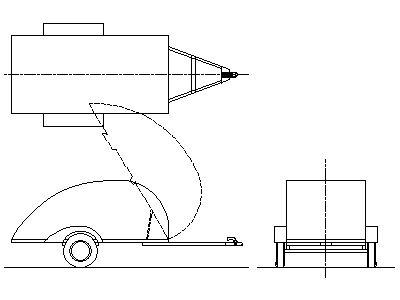

OK, OK, here is your own custom design! The body is 8' long, 4' wide and 3' high on a Harbor Freight 990lb or 1075lb trailer. Rather than get all complex with hatches and doors, it seems easier to build a teardrop-shaped box that is lifted up as one piece (with the streamlined fenders). I presume you can just lift the car out. It would be a good idea to build a raised floor for the car to sit on top and with storage underneath.
If you want this, with detail of the interior, construction, geometry, etc, let me know your email address.
Glad you enjoyed Britain - it's always a worry for me that our relatively low standard of service will put US visitors off. Basil Fawlty may only be fiction, but we have some people who think he's a role model.... I'm in the far North East, nearly in Scotland.
Andrew

thanks a bunch, I feel a little bad, that you went thru that effort, BUT I REALLY like the hatch idea. and the side doors are great as well. to be able to get at tools and supplies. Dont really want glass in em, but I think I will put a door on each side.
I think the trailer should be stronger, if the sides are attached to the trailer, but maybe im all wet on that idea???
