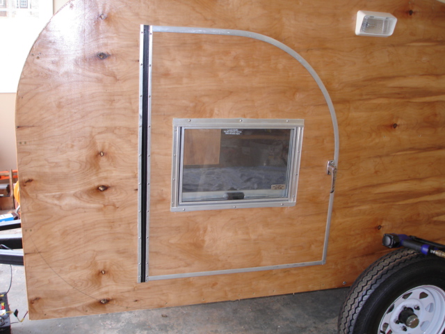

There's my pic. Going on 1 + year. No problem yet.

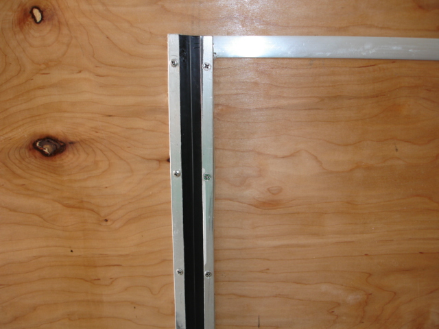

Closeup:
Notice, for a wider swing I countersunk the holes (on one side) and put in flatheads.
