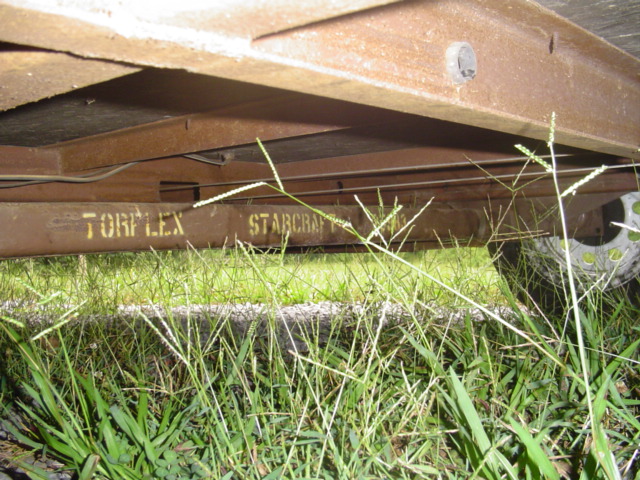

Postby Geron » Wed Aug 29, 2007 7:51 am
Got home with the trailer late last night.
Pleasantly surprises this AM when I looked underneath her.
Pic on the internet made me thing "SPRING MOUNTED AXLE"
Here's What I Found.
What looked like rust is simply the frame painted a rust color.
Right Now I'm really please with the purchase -- Time will tell.

Postby Podunkfla » Wed Aug 29, 2007 10:28 am
Wow... Ya did good Geron... Axle is worth more than you paid for the whole rig... Congrats! :thumbsup:

Postby Geron » Wed Aug 29, 2007 11:22 am
Podunkfla wrote:Wow... Ya did good Geron... Axle is worth more than you paid for the whole rig... Congrats! :thumbsup:
Well, that's true if the axle hasn't settled and is still good. I'll have to check the drop 22.5 degrees is normal and it can settle as low as 12.5 degrees.
Called the tech at Starcraft for the low down on it
