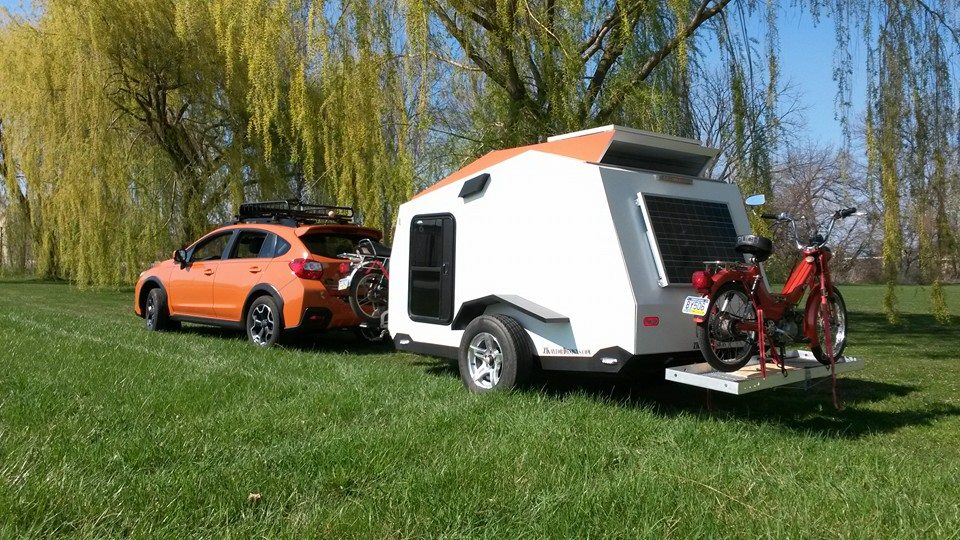

Usually in the camper or tow vehicle, or on the vehicle's roof rack. But sometimes you have to get creative.

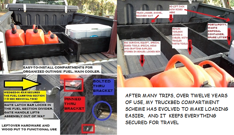

  • I'm trying to load everything in simple stages, for camping at a moment's notice, as opposed to my life-long habit of packing up everything (including the kitchen sink) over a two day period prior to any trip (whether a two day trip to a race, or a week at a beach). I've reduced prep time, and continue to pare it down more, by pre-loading as many of the essentials (no kitchen sink, now!) as I can, to be already in the truck bed, or in/on the trailer. I really need to get an SUV for my camping, or at least a topper for my open truck bed (to be kept away from thieves and weather), but for now I just throw sealed storage boxes in my truck bed (tools and EDC supplies, locked and cabled to the truck) and have the remainder of my gear sitting in the garage bay where I keep the trailer. I have divided compartments in the bed, to hold coolers, porta-potty supplies, extra fuel, on/off road jacks/stands, hi-lift, shovel, truck ladder, and extra tools for any occasion. All these are quickly set into designated spots, strapped down, in just minutes. My compartmentalized, open storage is shown here: http://www.tnttt.com/viewtopic.php?f=67&t=60546#p1088093

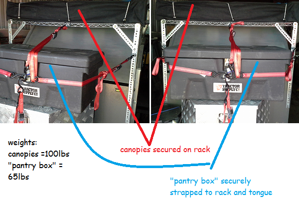

  • Other equipment is stored either inside the trailer, or on a front rack I recently added to the trailer, shown in this thread: http://www.tnttt.com/viewtopic.php?f=21&t=68441#p1203547. The canopies, and extra (bagged) chairs are kept strapped on the rack, while in the garage, and a folding camp chair, side-tables, and side-tent(s) all ride inside, strapped on the mattress (which is folded in half, allowing two Aquatainers to be strapped to an E-track on the inside front wall).
    TRUCKBED COMPARTMENT SCHEME 7-17-17.png (654.32 KiB) Viewed 1091 times
    quick to load up, secure for travel
    pantry box & canopies secured for travel.png (339.59 KiB) Viewed 1091 times
    latest configuration (subject to change)

When loading the trailer i put all the heavy stuff above the axle or as close to it as possible. Even If you have 10-15% tongue weight like you should but all the heavy stuff is at the back and front of the trailer and the tv is not heavy in comparison your trailer can become a see-saw over bumps and pick the tv's rear axle off the ground.
Its nicest to have auxillarys easy to grab from the outside. Roofracks on the tv catch a lot of wind but are convenient for bikes, canoes and rooftop carriers with eating or shower supplies.
Bike racks for the front of pickups are handy as are ones for the back of the trailer.
However that depends on where the axle is. The photo in the second post looks like sway city to me. Or at least the see-saw thing i mentioned.
