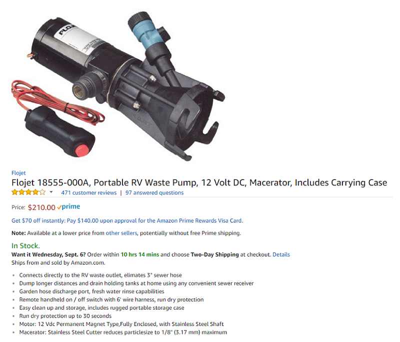

  • I've been examining the blackwater/waste disposal problem for a coupla days. The nearest "dump station" is only 5 miles from my house, but I don't like the prospect of having to load the portable tank into the truck bed once every week or so (the travel trailer has a 32 gallon holding tank). The RV websites I researched all concur that I need a portable tank as large or larger than the holding tank, so I might have to pull/lift/push a full 32 gallons of waste inside a 32-35 gallon tank into a pickup bed for transport to the dump station. At 8+ lbs a gallon (waste weighs more than clean water), I might be struggling with liading a nearly 300 lb tote-tank into/off my pickup. I really don't want to do that, with my bad knees/back/left shoulder. Plus, the tote-tanks of that size run over $200, and will entail more cost for ramps to use while loading it up.
  • I'm almost certain that, given the trouble and expense of using a tote-tank (and the physical strain I don't need), I'll be better served with a macerator/pump to use, connected directly to the black water port, then thru a 3/4" hose into my septic tank (access hole is 48.5 feet away from the waste port); price is comparable to the tote/ramp I would need, and much less hassle and physical work to use. Anyone used one of these units? I have read pretty much universal approval of these pumps, so it looks like the better choice.
  • Oh...you guys might wonder why I don't just take the travel trailer itself to a dump station. It's because

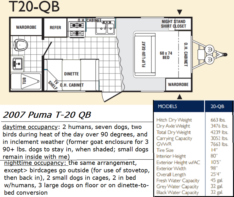

    2007 Puma T20 QB floorplan & specs.png (306.93 KiB) Viewed 4789 times
    our temporary domicile
    rv waste macerator-pump unit.PNG (318.39 KiB) Viewed 4789 times
    possibly my best/only hope for easy wastewater removal

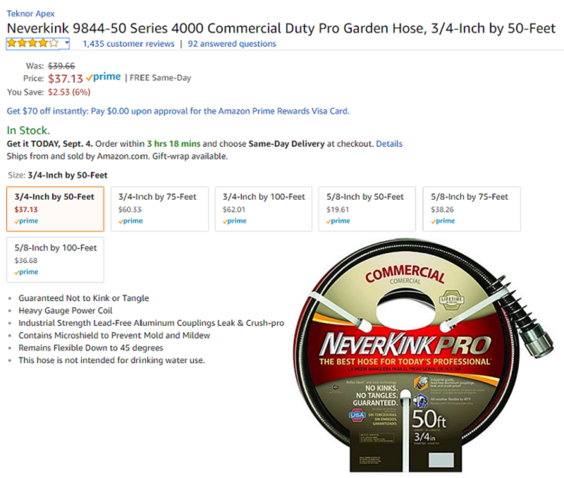

    hose @ Amazon.PNG (406.39 KiB) Viewed 4789 times
    I had better use a good hose for this dirty job!

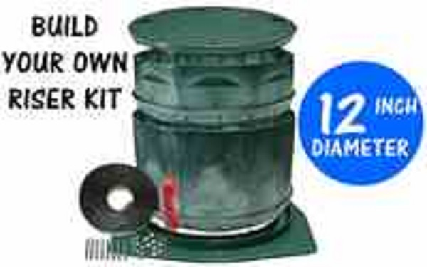

  • After digging up half the yard, I finally located both access caps for my septic system, and had them pumped. Both were 18" below grade, so to use the tanks for remote fill (from my trailer), I have to leave one accessible, while I re-bury (carefully marked though!) the other cap.The latest plan is to replace the 10" round concrete cap of one of our septic tanks with a Polylok septic riser kit, allowing me to either remove the cap at will (it will be above ground level), or to attach the macerator/pump/hose directly to a fitting I will install into the cap.
    I will need $155 of parts to build my own 12" diameter riserThat will work with the equipment I'm ordering

  • The blackwater solution parts arrived today: the $210 Flo-jet macerator/pump, and a clear blackwater valve extension tube (so I can see what's happening), and the Never-kink 50 ft 3/4 hose (to reach the septic tank) will be here tomorrow. I was going to put a tank riser on the septic, but I think I'll just leave it covered with concrete blocks 'til I need to dump the trailer tank (about once a week, at most). That'll save me $160.
