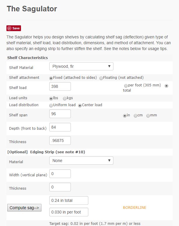

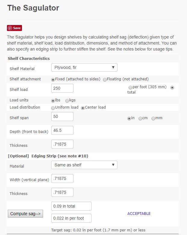

  • Here's a little tool, The Sagulator, I used to see if my un-supported roof, of 3/4" plywood, could be self-supporting even if I got up there with some tools, or install a roof rack there, in the future. I used Simpson Strong-ties gusseted angle braces to secure it to the walls, front slope, and inner rear bulkhead (all, also of 3/4" plywood), with the 51.5" x 48" plywood roof section resting on top of 3/4" ply, all-around. The galley roof was also supported the same way, but although it was actually part of the roof section, I removed its' 22" x 48" size from the calculations (the roof piece is actually 73.5 x 48"), since it has basically its' own structural supports, and really won't ever sag. http://www.woodbin.com/calcs/sagulator/
  • Also, here's my roof sag, that I confirms that my small, but thick, roof didn't need support beams underneath it, though I've since added a 4x4 cross beam inside, with 1" space between it and the ceiling, between the sidewalls (as a lift/grab-handle to help me in and out...I'm old), which I can use to fit in wedges to lift the roof, if ever necessary.

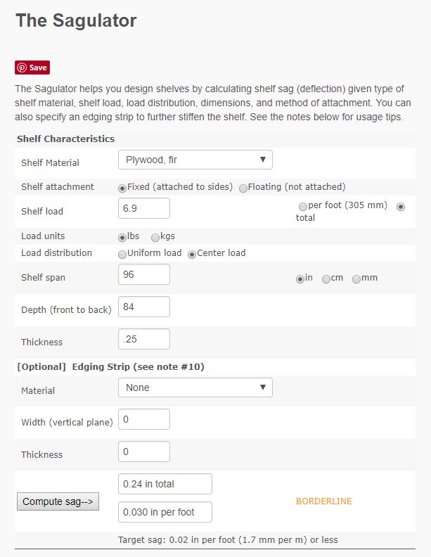

  • Also, I ran a preliminary calculation sample, using your data (what I know of it), which shows that the 1/4 roof you have will definitely sag without spars holding it up, an it becomes borderline holding only 6.9 lbs of loading (rain pooling, snow cover?). I also tried calculating just adding a 3/4" plywood sheet underneath the 1/4", and it doesn't show appreciable/borderline sag until 398 lbs of total loading is applied. I may not have all the pertinent data, or really envision your layout, but it is probably the way I would've gone on my tank-like TTT, and it at least shows what sorta ballpark you're in.

Going back to your Sagulator post, how is the shelf load determined? If total weight divided by square feet it should be about 2.
My original plan was a foam sandwich with 1/4" exterior plywood on top, 1" Foamular, and 5mm interior plywood as the ceiling. This should weigh about 92 pounds and be about 1.45" thick. I'f I'm using the sagulator correctly that results in zero sag. I'm wondering if I actually need the interior plywood for the ceiling although its not a sandwich if it only has one piece of bread.
