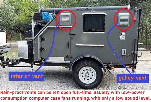

I used "10inch x12inch Side Vents for Enclosed Trailers" from Etrailer back in 2012-13 when I built my 4x8. I bought four, using two as cabin vents, one as the ambient air vent for the closed/sealed galley (tha A/C needed air), and I adapted one to use as a covering lid, not as a vent, for my A/C exhaust to exit the trailer, unimpeded.
side view, rain-proof vents with full-time fans behind.jpg (155.23 KiB) Viewed 1063 times
computer case fan over vents for good, cheap air circulation.jpg (261.75 KiB) Viewed 1063 times
I paid less than $20 each, back then, if I remember correctly, and watched as the price rose into the twenties, but now Etrailer wants $50 each for them. However, R & P Carriages offers a similar vent (maybe identical to the one I used) for $21
https://www.ebay.com/itm/295254892543?chn=ps&mkevt=1&mkcid=28&srsltid=AeTuncpZ-qMxL3VRYGpqYwe-_tYytT41sbGx3Yb6mbcMRzqre3VIHKqCE-U.
They never leak, even in major Texas thunderstorms.
