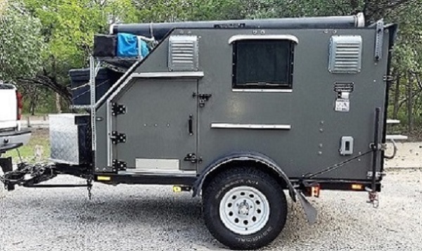

  • I also didn't want to put a fan on my roof, even though it already had a dozen 1/4" holes in it. I used stainless carriage bolts with acorn nuts/fender washers, for metal brackets securing the roof to the walls, in lieu of spars, sealed with PL adhesive, and painted-over with clear acrylic for further protection. But, I had no desire to cut a 14"x 14" hole for a rooftop fan/vent, inviting eventual leaks, so I decided on sidewall vents (with attached fans) for flow-thru venting, and a large under-shelf fan for maximum air circulation.
  • Having run a shipping/receiving department for many years, I was familiar with vents used on the enclosed trailers of the trucks I loaded/unloaded at work, and that never leaked, as far as I could tell. I liked the look of a particular vent, designed for trailer roofs, but usually mounted on the leading wall of most trailers I saw. I found it at E-trailer, for about $20. It was galvanized (grey-ish color), which was ideal to match my grey color scheme, and the overall rough/industrial theme. They've been extremely durable, totally leak-proof during all sorts of thunderstorms (including horizontal rain), and have been perfect for bug-free operation, during the past 8 years.
    9139 vent 1.JPG (41.77 KiB) Viewed 1444 times
    my vent(s) were galvanized; now they come painted white
  • It was an easy install, and I put plastic screening between the butterfly closure and the wall, to keep out insects. But, I was not finished with them, yet. I added a swing-away bracket (piano hinge) to mount 120 mm hi-flow computer case fans for added circulation (if I wasn't using the 10-inch 120vac main fan). They are 12vdc, and use .18 amp-hour each, so I can use them for many hours, without much impact on the battery life, if off-grid.
