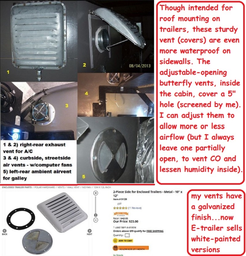

* I use metal roof-top vents (intended for enclosed semi-trailers) mounted on my sidewalls, and usually left partially open. They are quite waterproof, and have an inside baffle to keep water out, and there's a butterfly vent closure if you want to seal out dust or airflow (I also put bug screen inside, too). Bought them from etrailer.com. See my post on this thread: http://www.tnttt.com/viewtopic.php?f=2&t=73034&hilit=+wall+vent#p1267736
vent 9139 used for three purposes (1).JPG (242.93 KiB) Viewed 1146 times
