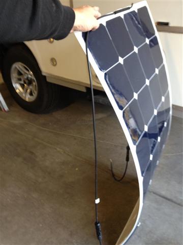

panels, I wouldn't be able to lift it. Enter eBay with a 90 watt, high efficiency,
flexible solar panel that only weighs 4 pounds.

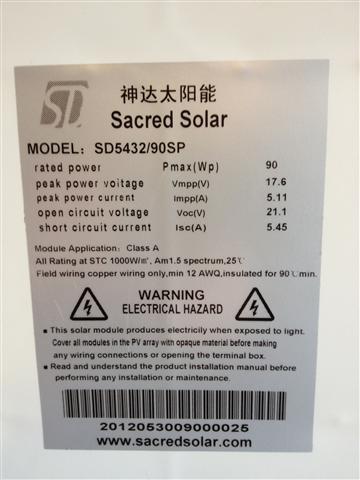

The panel is 19% efficient, which is quite a bit higher than my nicest panel, a KD135 Kyocera (which I think is around 14%). It's set up for charging a 12V system so a traditional PWM controller can be used. The panel voltage is compatible with the existing
panels at 17.6 Vmp so I could run all the

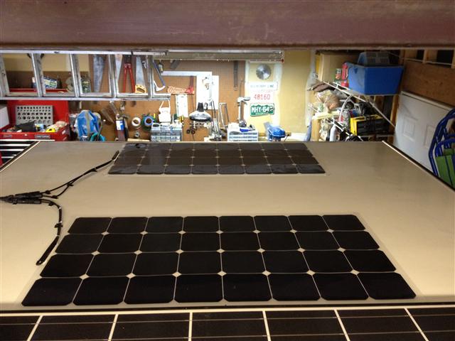

I attached the
panels directly to the roof using 3M VHB 4941 tape. I cleaned the surfaces with isopropyl alcohol and used a roller on the tape to ensure a good bond, per the 3M instructions. I also made sure it was warmer than 60F when I attached them. I've tried to pry them off and they feel like they're attached pretty good. I hope so as it would suck if they blew off.

The
panels are very thin compared to the traditional
panels on the roof, I'm hoping the won't be in the wind much at all. They're certainly a lot smaller than anything else I've bought to date. I tested one that was tilted to the sun and it was putting out 85 watts, which isn't bad for a 90 watt rated panel.
I rolled the trailer our today and the
panels were putting out 6 amps. Not bad for
panels laying flat and a charged battery. That puts my roof PV capacity at 400 watts. Add in another 140 watts of portable

These new
panels seem a little delicate, the composite surface scratches pretty easily. I don't think I would leave these in the sun all the time. Since the trailer is garaged most of the time I don't think it will be a problem. I'll need to be careful cleaning them to make sure I don't scratch them up. I keep saying I'm not going to buy any more
