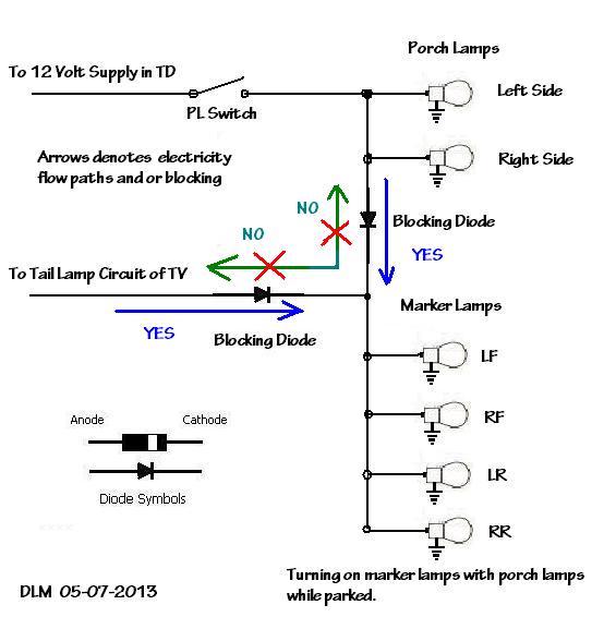

A blocking diode is a one way valve (so to speak) that will only allow electrons (electricity) to flow in one direction through it.... Sort of like a "check valve" ( reverse flow preventer) in a water or air system.... The electrons flow in same direction as arrow in diode symbol and can not flow in opposite direction..
http://cie-wc.edu/Diode-Theory-4-22-2011.pdf
Porch-marker lamps-2.JPG (35.98 KiB) Viewed 672 times
Also one could add a simple disconnect switch to disconnect marker lights circuit from porch light circuit of you do not want markers to come on with port ch lights....
NOTE: It has occurred to me the diode symbols may be in diagram backwards, if you try circuit and it does not illuminate lamp circuits properly, just reverse direction of diodes....
Dale

This is the way I'd do it. Automatic, nothing to forget, and you don't have to think about it.
Dale M. wrote:Absolute easiest way to make driving markers come on with porch lights would be to just add wiring from 12 volt source inside trailer that powers porch lights and control them from porch light switch.... However you may (will) need BLOCKING (isolation) diodes so porch lights are not on when in tow mode (clearance lights only for trailer) or so you do not feed back to TV with power from trailer to TV lights while parked but still connected.....
http://www.the12volt.com/diodes/diodes.asp
Dale

No... You didn't understand Corwins's solution, the second vehicle connector style connection IS on TD and uses TD battery to energize marker lamps... Just as you took so much pains to describe, concept was already in Corwin's solution.......
Dale
