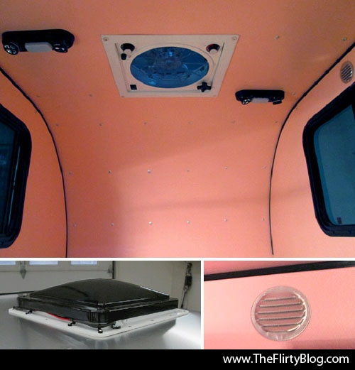

Postby deleted » Wed Jun 26, 2013 8:06 pm
I just picked up my tiny trailer a week ago but have already endured multiple torrential rain storms, simple showers, and a white out hail storm. I can say from experience that having two passive vents on opposite walls will be appreciated when the rain is coming down hard enough to come through the top vent/fan or blow in sideways through the windows. There was one night when I had to shut everything down to keep the rain out and had my builder (Alaska Teardrop here on the forum) not put them in not only would I have felt deprived of oxygen, the condensation build up in the trailer would have been really bad by morning.
This image shows one of the passive vents. The passive vents on each side were the only ventilation source that didn't allow water to blow into the trailer during the worst storms.

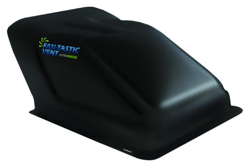

Postby les45 » Wed Jun 26, 2013 8:26 pm
I'm glad to hear that someone on the forum has experienced rain coming in through their vents. When I advocated in a previous post the Ultrabreeze for the Fantastic Fan as a solution to that problem, no one had ever had rain come through their vents. Well I did and that is why I bought this unit. I now leave my vent wide open all the time without worry about rain, even when driving. I've experienced several heavy rains with no leakage. I also leave it wide open during cold weather. The nice thing about the Ultrabreeze is that you can pop it on or off with four quick release pins. I like the way it looks on my weekender so I just leave it on all the time.

Postby atahoekid » Fri Jun 28, 2013 12:05 am
les45 wrote:I'm glad to hear that someone on the forum has experienced rain coming in through their vents. When I advocated in a previous post the Ultrabreeze for the Fantastic Fan as a solution to that problem, no one had ever had rain come through their vents. Well I did and that is why I bought this unit. I now leave my vent wide open all the time without worry about rain, even when driving. I've experienced several heavy rains with no leakage. I also leave it wide open during cold weather. The nice thing about the Ultrabreeze is that you can pop it on or off with four quick release pins. I like the way it looks on my weekender so I just leave it on all the time.
Glad I tripped across this thread! I have had water drip into the Road Foamie through my slightly open Fantastic Vent during some heavy rain storms in the redwoods of NorCal and along the Oregon coast. I might have to get an Ultrabreeze although with my side windows open we got plenty of ventilation and no incoming rain
