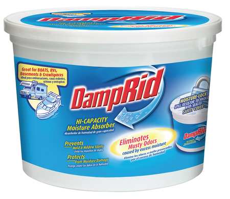

Sorry to hear about your mold problem. Here in Virginia we know all about high humidity and heat. We've learned to frequently check our trailer, always on the alert for any leaks or dampness. Since the "CrowsWing " is too tall to fit in the garage, it has to stay outside year round so no airconditioned storage for it. One thing we do that has helped a lot is to place "damp-rid" in the cabin and galley. We take them out when we travel and put them back in as soon as we get home. We use the large size mostly, but we do have the little size in the water compartment to decrease sweating on the watertank. They work wonderfully and are available at Walmart.
Hope this helps,
