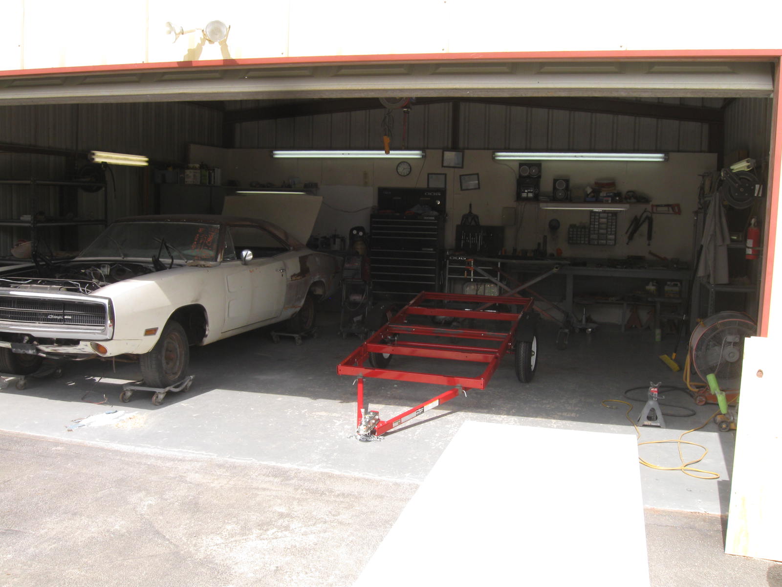

Postby kd5edj63 » Sat Oct 05, 2013 2:47 pm
Attempting an image upload
kd5edj63
Posts: 130
Joined: Fri Oct 04, 2013 3:17 pm
Re: I am ready to build.
Postby kd5edj63 » Sat Oct 05, 2013 9:03 pm
I guess the pic came out a bit big :oops:
I made some good progress today. The 4x9 platform is ready. Its bolted to the frame via 8 carrage bolts and is 2 sheets of half inch ply (not birch) with a 2x4 structure in between. I used Henrys ruberized white roof coating to protect from weather. Top and bottom. So tommorow will be deaming up "floor plans " for the cabin. Im stoked to build this project :D
Its currently on jack stands since I just got done sealing the frame to the wood where the wood and frame make contact. I dont want moisture living in between the frame and wood floor.
I used a seven eighths inch wood boring bit to "hollow out" the floor area where the trailer bolts would otherwize keep the wood floor from sitting flat and flush on the trailer. Right before I placed the floor, I filled the voids with "liquid nails" to keep water out of thos voids. :thumbsup:
