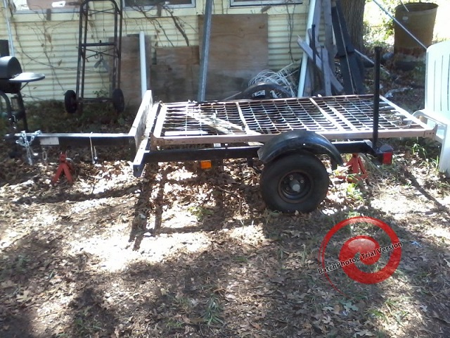

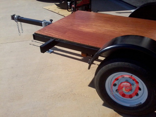

Here was my official start: I thought I'd finish it in 3 months.
10/1/2011 start
It looks like you have the advantage. It took me a month to deconstruct, reconstruct, and get it to a rolling platform stage, to weigh, and register. I thought I'd finish it in 3 months.
11/4/2011 roller
Then came the long haul...a one-year period of stops and starts, lots of progress interspersed with none. I brought it home from my friend's shop (he welds!), 50 miles from my garage, to complete (in Nov.2012).
9/8/2012 photo, same on 11/6/2012
Interior was completely bare, nothing but the generator in the galley, and no windows or even a completed door. Just a painted shell. I thought I'd finish it in 3 months (in Oct.2011). I thought the same (in Nov.2012). I thought the same (in Mar.2013). Then came the changes, the re-fits, the re-engineering of the doors, A/C, electrical. I was sure I'd finish it in 3 months. I did. Then I did it again, in 3 more months. The point of this saga is that I assumed I would build it in 3 months, so I never started a journal. Then I thought it too late when the erratic build pattern became sporadic. It's the biggest regret I have about the whole process. I look forward to your build. Best of luck!
