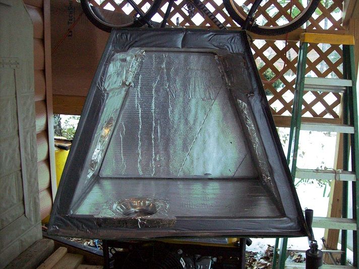

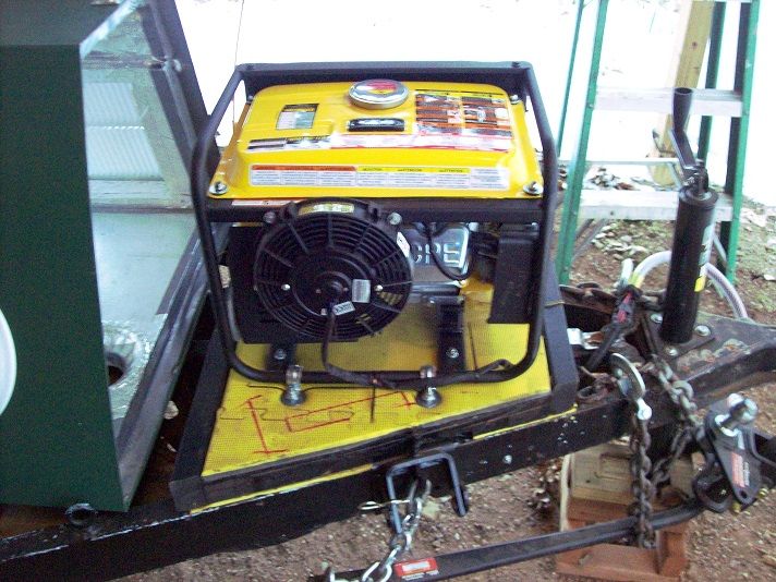

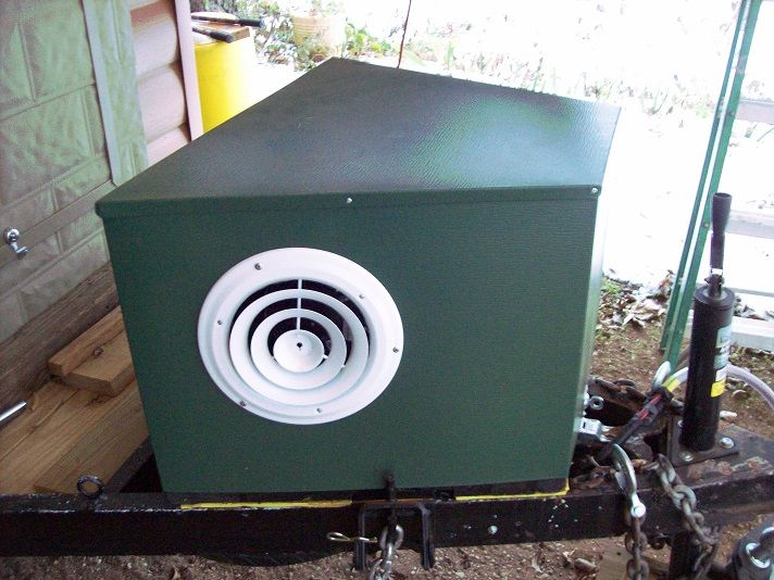

I bought a 1400/1800 W Champion and built a box from 1-1/2" foil faced polyurethane then covered with aluminum sheeting. The box also provides weather protection as the whole setup is mounted to my trailer tongue.
The gen sits on a piece of 1/2" foam rubber floor mat over plywood framed underneath with 2x2 and insulated in between. Another 1/2" foam rubber mat is between the box and trailer frame.
I put an air intake on one side and cooling outlet on the other using standard register vents. I have a 12V radiator fan mounted in front of the outlet. I also made a 4" double wall opening for the muffler exhaust and once the cover is on can screw on a stock cylindrical muffler from an 18HP Briggs and Stratton to the spark arrestor on the gen muffler. I added an external kill switch to stop the engine without having to unscrew a hot muffler.
With just the box I estimate a reduction of about 20-30% and the muffler another 10-20% so overall 1/3 to 1/2.

Postby M C Toyer » Mon Dec 09, 2013 11:09 pm
Insulated generator box on tongue showing cooling outlet:
Cooling inlet and muffler extension at back:
Cooling exhaust fan:
Interior of box. I left the foil facing on to protect the polyurethane but may remove in places for better sound-proofing.

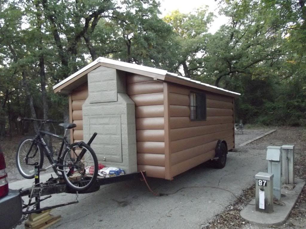

The faux stone behind the generator box is for tool storage and at the top covers the air conditioner. It is made to resemble a chimney and has an extension (not shown) that sits on the roof with magnets and hides my TV antennae:
The space between the chimney and generator box is for firewood and/or my bike or mc. I moved the bike/mc mount back to install the generator box.
