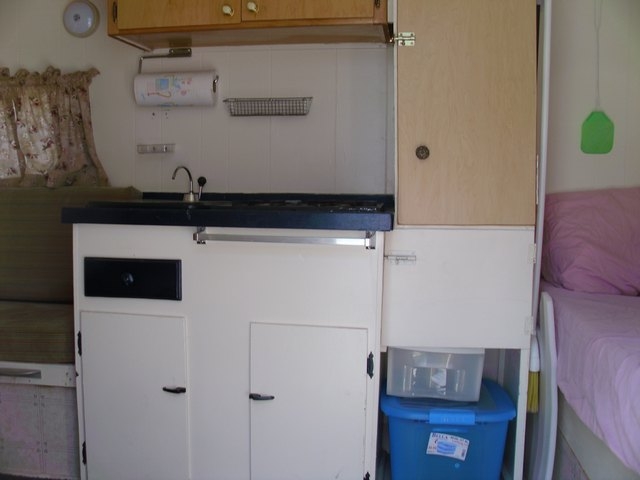

Postby Kathy53 » Fri Mar 28, 2014 8:22 pm
Looks like the faucet is hooked to the fresh water tank but not to the city water. looks like part of the hook up is there. Just needs the right faucet and pipe etc to the city water connection. Am I guessing correctly? It looks like he went a little crazy with the what ever is all over the bottom of the sink. At least I think it is the bottom of the sink.

Postby 48Rob » Sat Mar 29, 2014 6:42 am
Hi Kathy,
Yes, the hand pump line should go to the tank. When you pump the faucet water is drawn fron the "fresh" water tank.
The stuff on the bottom of the sink is likely silicone or similar goop used to make the connection from the sink to the drain line using parts that weren't designed for the purpose by someone that didn't know that a special "sink to hose connection" drain is available.
All you need for the city water is a faucet, with the hot side capped off, and a water line connection from the cold inlet on the faucet to the city water pipe coming through the wall (assuming the other end of the pipe has a hose connection).
You can also opt for a single faucet, no hot and cold combined, just a single handle and spout since you don't have a hot water heater.
It will take up a lot less counter space.

Postby Dale M. » Sat Mar 29, 2014 9:11 am
Kathy53 wrote:Looks like the faucet is hooked to the fresh water tank but not to the city water. looks like part of the hook up is there. Just needs the right faucet and pipe etc to the city water connection. Am I guessing correctly? It looks like he went a little crazy with the what ever is all over the bottom of the sink. At least I think it is the bottom of the sink.
Viewing what you have here, I think I would rip it all out and start over......
Lots of correct solutions to your questions without having to deal with previous owners mess....

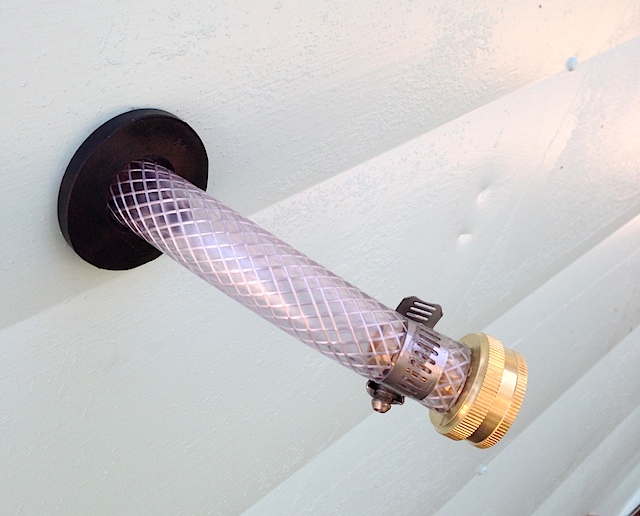

I just fixed two of my campers water hookups and it was far more trouble to make the old stuff work than to get the few components new, and hook them together. In your situation, it sounds like you are not interested in the freshwater holding tank, and manual pump system and want a simple way to hook up to a park's system. In my own opinion, I wouldn't remove the existing plumbing, but completely ignore it and build a simple new system in tandem and here is a shopping list :
*Space saving style faucet and only use the cold side as Rob noted. you might consider a "One hole/one handle" faucet for additional space saving.
*Connector from the faucet cold side to a 1/2" inner diameter barb adapter.
*1/2" inner diameter hose rated for drinking (On the same isle at HD as the brass adapters at my store)
*Brass 1/2" inner diameter barb to garden hose adapter
*Two hose clamps
*Rubber PVC grommet that the hose will fit through with a lip that will grip the outer wall once in place (Auto part store)
*15' drinking water rated hose to hook to the camper and campground hook up.
Here is a pic of my recent rig up. I already had the faucet and pipe coming down, so I just flared the existing brass line coming off the sink and attached the hose and ran it out of the wall. The original hookup was through the floor and was a major pain, and going through the wall involves cutting but looks very clean, but you can go through the floor if you prefer. You can slide the hose into the wall for traveling so it looks nice and pull it out to give you a good hand hold when attaching it at a campground.
