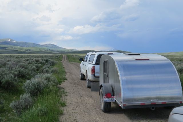

I do a lot of boondocking, not four-wheeling, but frequently a ways from the gravel.
I'm using a Dexter torflex and light truck radials. The axle is derated to 1400 pounds and the trailer weight is about the same. Mine rides like a dream on the bumps.
The above photo was taken about the same place my avatar photo was taken –and that's my old Hunter built commercial 'drop. It too had a torflex (It was a Number 9 -unknown de-rating), but had standard bias trailer tires. My new beast rides noticeably better. The old trailer wasn't bad but I believe the radials really help.
