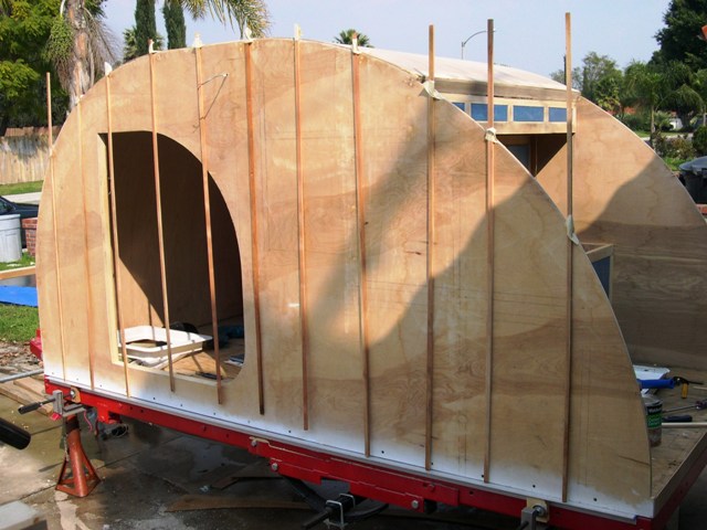

Place a length of angle iorn along the bottom rail of the tear, to rest the skin on and placed several 1/2" x 1/2" spacers that I had ripped on the table saw, tapped verticaly along the side of the tear to prevent accidental of the skin until I was ready.
When the coat of contact cement was dry to tachy-touch with help, tilt the aluminum skin to the spacers, start removing spacers one at a time working from either end, but not both, to prevent bubbles, as you smooth the skin into contact with the sides.

Postby alffink » Wed Aug 05, 2009 9:09 am
Linda
Had to go back to my old files but found this image, shows the spacers and the angle ready for the aluminum skin. Hope this helps with my discription from my previous post.
Oh, I skined one side, crawled inside drilled small holes to mark corners of door frame then skined opposite side. when skining was complete cut out first marked door crawled inside marked opposite door. this way I did not have to perfectly align the side skins and door openings.
I just used painters blue tape to hold edges until trim was in place.
