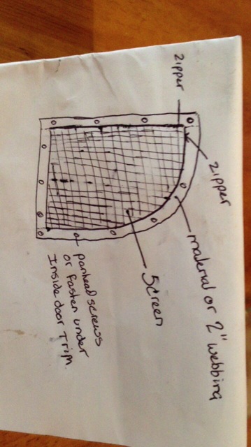

Postby backstrap bandit » Sat Mar 14, 2015 4:52 pm
I just figured out how to have a screen door on a tear without having a wider wall or door jamb it will be fastened inside under interior door trim check out the crude pic

Postby Java Jack » Tue Mar 17, 2015 9:57 am
Nice, that is how Camp-Inn does it on my 560 Ultra. Zippered screen that is mounted to the interior wall.

Postby backstrap bandit » Tue Mar 17, 2015 7:51 pm
Thanks java j been trying to figure something out and that came to me while fixing screens on home didn't know it was already being used oh well! But I would like to see pics if u have any

Postby Java Jack » Sun Mar 22, 2015 9:10 pm
Sorry it took so long, been a little busy this weekend.
I was mistaken on how they attach the screen doors on my trailer.
Actually, there is a metal lip around the door. They then sew some rope or elastic into the fabric and stretch it over the metal lip.

Postby backstrap bandit » Sun Mar 22, 2015 9:15 pm
That's ok jj but that is almost the same concept and thanks

Postby doris s. » Mon Mar 23, 2015 1:00 pm
I made screens for my teardrop. I hung them on a curtain rod inside and just roll it up when I'm not using them. You can add a few velco dots to keep it in place on the sides if you want too. It works great.
