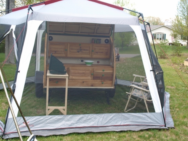

I use a 12ft X 16ft tarp to create a large dry area over my galley by attaching one side of the tarp to the teardrop, pulling it over the galley hatch, and then putting tarp poles under the open end.
109912
It works well so long as the wind isn't blowing directly into the open side. In that case, it's a total disaster ;-)
