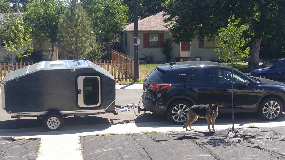

Postby DaBearSox » Thu Jul 20, 2017 6:39 pm
Got her hooked up today and took a few laps around the block. Seems like the ball is too low. One wheel is actually on the curb so it doesn't look as bad there but was pretty jerky over bumps and felt the weight on the rear of the car. I can't even lower the coupler onto the ball with the jack. So think I need to get a little higher ball mount. Image

Ideally with bumper pull trailers you want the trailer level or slightly tilted down. You dont want it tilting up, but what you have is tilted too far down, so juat flip your reciever over and see what it looks like.

Postby DaBearSox » Sat Jul 22, 2017 9:09 am
Bought an adjustable mount today and that did the trick. Took her out on the highway and pulled very well. No sway what so ever and the CX-5 did a nice job pulling her. She shakes (up and down) a little bit at lower speed but then it stops when I am at 45+ so I am wondering if that will be rectified when I have her all loaded up.
Much Better

I had the same problem with my stock 5.3X12 NT trailer tires when I first towed it. That's just the nature of the stiff trailer tires. I cured the problem by going to passenger car tires in a bigger size (175-70RX13). That's the largest size I could use and still clear the frame. I did have to raise and widen the fenders a little.
