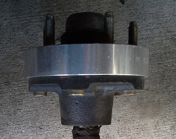

  • No, mine were one piece, 1.25" thick (I found a picture and some other info, but not the manufacturer's name). The 4-lug trailer hubs used SAE inch sizing, but the 5-lugs on the adapter were metric, so I had to get new lug nuts. Otherwise, it was a painless addition that worked fine.

  • My transition from 4-lug to 5-lug was done by switching to a 5-lug hub, instead of using a new 4-lug hub, when the larger bearings were installed. I see where my friend removed the new 4-lug hubs, and swapped them for new 5-lug hubs after our phone conversation about going to bigger 14" wheels. I was 110 miles away from his shop, and never remembered seeing it done, so my once-photographic memory had no memory in place, of the 5-lug hubs. By the time I was able to return to his shop, with 14" wheels, the new 5-lug hubs, and the new spacer-adapters, were already on the trailer. So, the hubs used were 5-lug (4.5" bolt circle) already, and a standard spacer-only type adapter was used (only there to furnish the extended hub-face and lugs, not to "adapt" it to a different bolt-circle). I apologize for confusion I may have added to this thread, with misinformation.
  • I worked 110 miles away from the shop where my trailer was, and 60 miles from my home...I had to make weekend trips out there to work on it, and my long hours and long commute made daily visits impossible. For that reason, and my aged 67+ year-old failing memory, I mixed-up details. Sorry about that, Chief!
