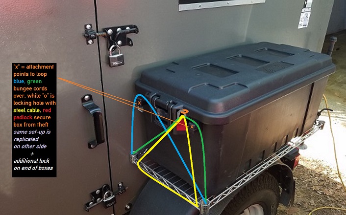

* I'm a great fan of 1)bungee cords / 2)padlocks / 3)steel cables to secure my gear, i.e.:
  • 1) I use 15-20 bungees at camp for my canopy, 10 inside the trailer, and 10 to secure my truck bed tarp covering,
  • 2) there are 8 padlocks in the bed of my truck, 10 currently on my trailer, and more to come, and
  • 3) I use 3 steel cables to secure gear inside the truck bed, and a really strong one to thread thru a trailer wheel to lock it to the trailer spring for theft prevention. And two chains to lockup my spare tire, with another padlock....
* Surely, that's plenty, but the two new side-mounted cargo boxes will require 8 more bungees, and at least two more cables, and 4 more padlocks, to satisfy my "secure gear" mania. I guess I lived in too many apartments early-on, then had theft problems while my gear sat exposed at some sketchy dragstrips, then didn't have enough enclosed storage at my semi-rural home for too long...you get the drift...I hate thieves and am sure that whatever isn't strapped & locked down will eventually get away. Or blown out of the open truck bed....
* So, I'm gonna use 4 straps per box (probably 15" EPDM-type), and one steel cable thru a padlock on each box, and another padlock on the other end of each box to keep the lid from coming off.

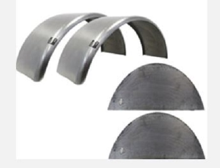

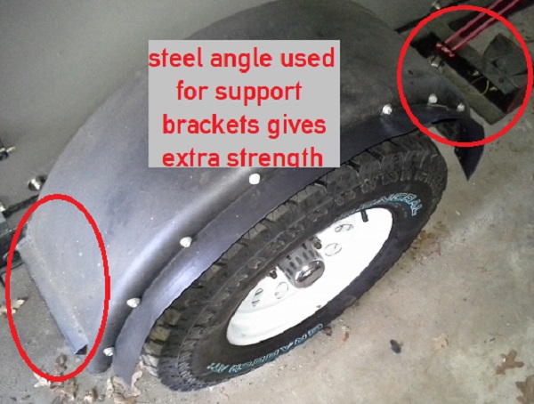

* Those two side-mounted boxes are 68 quarts capacity each, so I figure that if I was able to pack them solid enough to fill entirely (for instance, with water), then the added total weight would only come to 320 lbs (160 lbs per side).
* Calculations: (142 lbs water weight) + (7 lbs box) + (2 lbs padlocks + bungees + cable lock) + (8 lbs rack +pad + hinges) = 160 lbs
* Of course, they will not be packed that solidly, but instead packed with expendable supplies in box #1: trash bags, "Double Doodies", TP, kitchen wipes, paper towels, emergency "drying towels" (worn-out bath towels from home-), inside-cabin boot storage (small plastic trash can), etc...., and in box #2: tackle box, fish basket (IKEA collapsible-mesh clothes hamper), catfish stink bait (in tightly sealed jars), minnow bucket, small 8" electric fan (used for when I'm sitting outside the trailer, on a hot day), container with various small gadgets and tools I use at camp.
* The weight of all those listed items is relatively negligible (total estimated, offhand, as under 45 lbs per side), and the weight will be centered just slightly rear of the axle, so the tongue weight might decrease by a couple of %, and the tongue itself will not be negatively affected. Besides, at 3" square x 3/16" thick, it would take a lot of extra weight to make any detrimental effect happen.
* The tongue is strong, but the suspension is even stronger, having been retrofitted with a 3500 lb axle, 3000 lb springs (yes, I knew I would continue to modify/make heavier the trailer, beforehand!), and with 2" x 1/4" steel angle added to the framerails. I've been thinking about welding that same steel to make my single beam tongue into a true A-frame tongue, for ultimate strengthening, but it probably won't be needed, since my future plans no longer call for true-offroading capability (too old to begin now). Plenty strong as-is for State Park use.
* I failed to mention that each fender is pretty strong, with a 16 gauge backing plate firmly welded on, then welded to the frame, and has additional stiffening brackets front and rear. I have stood on each fender before, and there's no give, so each can easily support the side-boxes.
