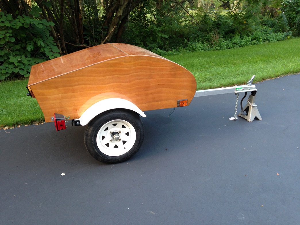

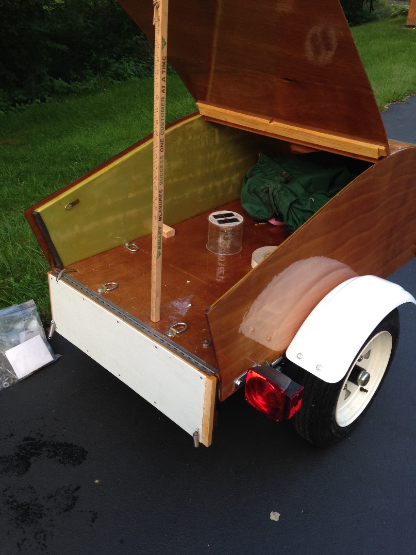

Postby kerryb » Sat Jun 08, 2019 3:53 pm
This is my take on tack and tape...A teardrop cargo trailer to pull with my motorcycle. most panels are thin marine plywood laminated to 7/16 styrene foam (building insulation) with 6oz. fiberglass cloth. Too bad I didn't have an aluminum trailer to put it on, the box weighs 35 lbs and the steel trailer frame weighs 118!
The clc teardrop camper is an ideal trailer kit if you like the shape, it is already very aerodynamic. Having built a couple kayaks from their plans, I am confident the design works well and is easy to build...it just looks a little different.
153lb teardrop cargo trailer
