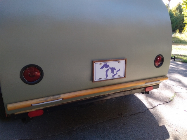

Wisconsin is also a bit "different". Any trailer under 3000 lbs is not required to be registered (licensed) or titled.
For my teardrop at ~1500 lbs I chose to do both as I hope to make some trips someday across the country. Though I have traveled with it to Ontario and about five different midwest states I have never been stopped and asked for registration.
For one of the pop-ups I demo'd recently the previous owner didn't apply for title or registration. And they don't know the name of the owner previous to them. The WI DMV's website wants the last name of the titled owner. I did check on the DMV site and there is a clear title (no Lien) on this VIN. So when I talked to an actual person via email they told me that the chassis can be titled under a homebuilt title and then registered even though it started out as a manufactured chassis and I have the VIN available. A new VIN is created.
So every state is different. I hope yours is at least as easy as WI makes it. Though the $167 title fee is quite a hit. I'll still apply since my daughter is likely to end up with the camper and I don't want her to have any trouble down the road.
My "normal" plate...
Tim
Niagara, WI
