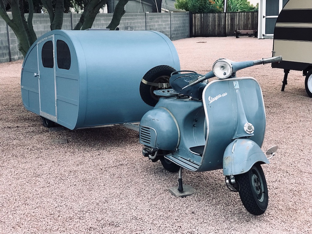

The total finished weight of the teardrop is a mere ~170lbs and it tows behind the vintage Vespa fairly well. The limitation is actually the trailer...when I thought for sure it would be the bike. The 150cc 2-stoke motor pulls strong and the manual transmission definitely helps while towing. Even the bike's dual-drum brakes do a good job stopping the trailer. The limitation is the solid axle on the trailer. When I hit a sizeable bump or pothole it will sometimes bounce the trailer wheel(s) a couple inches off the road. I found that adding some cargo over the axle helps...as well as trying to avoid road imperfections.
I had the trailer out over the Thanksgiving weekend for some camping. Video below. There's closed caption commentary if you click the "CC" button in the YouTube viewing window. There's also a link in the description box if you are interested in seeing the "tour/reveal" video.

Have you calculated the pressure 'required' for the full
trailer weight including occupants?
:thinking: I was able to reduce the tire pressure in my tear's
tires enough to reduce rebound on the road and still provide
enough for control and support.

Well...the problem is the tires are foam filled / non-pneumatic. What I'll probably do at some point soon is find pneumatic replacements. I'll post back after the solution :thumbsup:

Great-looking trailer and nice video, thanks for sharing. A couple of questions:
—What trailer did you use as the foundation for the build?
—How did you keep the weight so light? Did you follow a particular set of plans?
—The trailer lights did not appear to be connected in the video. Any trouble connecting those to the Vespa?

My friend and I built the trailer frame from from scratch. It's made of aluminum and with the tires and axle weights only 26 pounds.
I did not follow any plans. I designed the trailer. There's a lot of aluminum, foam, canvas, glue, ash wood, and other super lightweight materials used in the construction process.
The trailer lights are not currently connected. A 1962 Vespa does not have a battery as part of it's electrical system. The electrical system largely relies on OHMS to operate...it's incredibly crude...even for a 1960's vehicle. I barely understand it...it's a process to even figure out headlight and tail light bulbs without causing other bulbs to pop when it's time for bulb replacement. I might just turn the trailer tail lights into constant ultrabright flashers with an onboard trailer battery and call it good.
