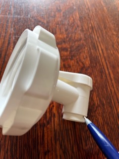

The spout from my 7 gallon Reliance water jug spout is leaking. See photo where it's leaking from...at point of pen. I'm wondering if this is a common occurrence with these spouts (like does anyone else have this occurrence)......or do I just have a faulty spout?
Thanks
John

I've had they types of spouts leak both new and old, its not something you can really fix.

It should not leak much. We put a Ziploc (with a paper towel in it) around the spout while the hatch is down. If that doesn't fix the issue, the spout needs to be replaced. The spouts do wear out and we've always got an extra one in the tongue box.

YES!! WORKS. And thanks to Lauren, I replaced mine. 3/4" spigot. Ordered from ACE Hardware, online. At first I didn't have luck screwing the new spigot onto the Reliance cap. But I saw the starter thread on the new spigot needed a bit of filing. After that it screwed in nicely.... a rather tight fit (did not use teflon tape) but screwed it all the way down into the cap. No leaks from what I can tell.
