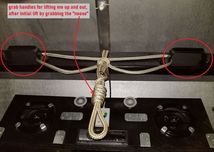

Mine is set-up the same as yours (except I have a second door, JIC); it was designed/built when I was 61-63 y.o., so it was easy to get in and out. Now, at 73, with bad back, knees, and you-name-it, I can't get up and out of the trailer without help.
getting in: Love under overhead shelf.....getting out: use lifting noose and grab handles
inside cabin arrangement.jpg (245.15 KiB) Viewed 984 times
A few years back, I put in an overhead crossbeam above my mid-torso (when laying down), which has two sturdy "gate" handles (the same as I use everywhere else on the trailer) and a hanging "noose" mounted on it. The crossbeam is a 4x4 mounted via lag screws between the walls, (it's not needed to support the roof), and easily supports my 225# weight and more. I lift myself with the soft noose, grab the handles, and lift/scoot forward to the door (after I remove the locking bar, while still reclined).

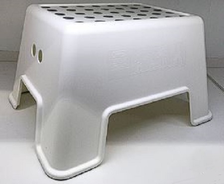

I then kick the door opened, and propel myself to sit up resting on the doorsill, before I exit. I do have to watch out for the overhead stereo shelf, mounted between and above the door frames, and alway look out before I step onto my Ikea Bolmen stepstool (I have a phobia about snakes).
